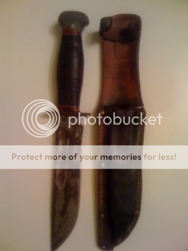

Hey guys,
I have an old knife that my Gramps carried during WW2.
it says RH "Bal?" 36.
Blade is rusted, guard is loose and the handle could use some touch up.
Where could I send this off to look pretty again?
Thanks,
-Richard.

Bal actually equals Pal. RH= Remington Hunting. Pal bought Remington's cutlery business when Remington left it to persue WWII contracts.
The model 36 is a common military knife, you could probably buy a new mint one for the cost of refinishing($100-150). My advice is oil it and leave it be. You will be erasing any history the knife may have if cleaned.
1) Get some wd40 or Mineral oil and keep wiping the blade down, changing out paper towels, etc
2) if its alot of rust then move on to 000-0000 Steel wool and wd40 that should take care of most of it and should make it look much better.
3) As for the leather, if its really shrunk up ya might try mink oil or sno seal something like that, some people recommend using a hair dryer to warm it up.
I say all that to say this, Making it all nice and shiny would ruin it in my opinion, you can get it to usable without completely skinning the cat;)

Yes, don't restore it. You will ruin its history and value. I made the mistake of refinishing my grandfather's Springfield 1911
