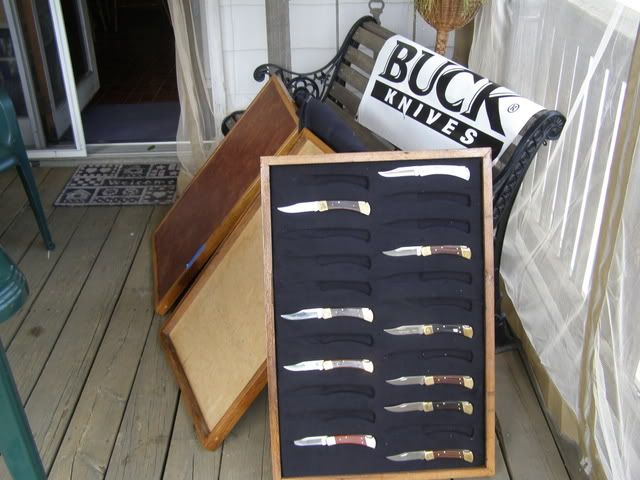

I'm hoping that someone can tell me where to look for the velvet (or fabric) covered foam like the stuff used in these display cases.
http://www.bladeforums.com/forums/showthread.php?t=693219
I'd like to use some nice wooden boxes that I have as knife display cases, but I have no idea what the stuff is called or where to look for it.

Dave, I don't think you are going to be able to purchase what you want ready made. I think you can find a thin layer (roll) of flexible styrofoam (not the hard, brittle stuff and not foam) at most hobby type stores; then find some velvet at most any fabric store. The velvet can be attached (glued) to the styrofoam using an aerosol can of "glue" commonly used for matting pictures (again available at most hobby stores). Spray the glue evenly over the surface of the styrofoam as well as to the back side of the material and let it set for about 30 seconds; then lay the material over the top of the styrofoam and I think that should work for you.
I agree w, Tin Sue . Be sure to cut the knife frames tight in the styrofoam so it holds the knives secure during transit and shows . Good luck . DM

i am building a wall display for leroy now using royal blue velveteen...
you have to decide if you want the knives recessed or not
if you want to put it on the wall most likely they will need to be
and supper mags embedded will also help !!!!

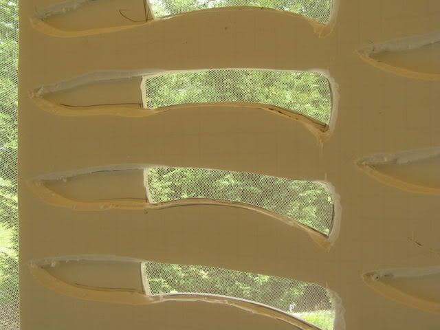

at wally they have a poster foam board in office supplys
you can cut the profile out ...well jest look

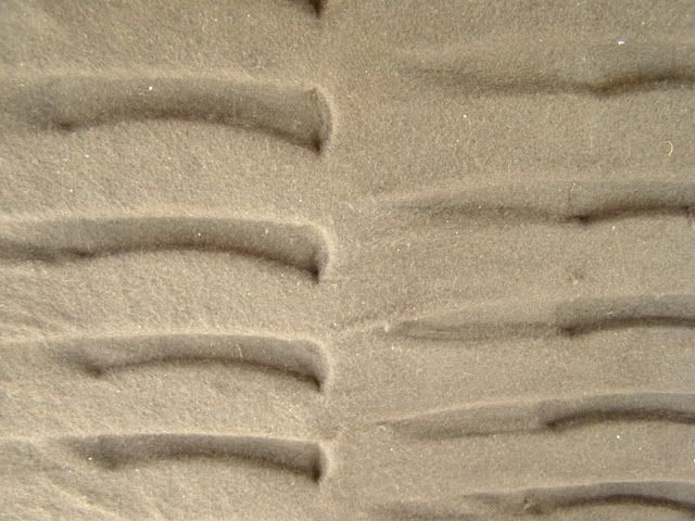

if it will lay down it is easy as you use a real soft rubber foam
and lay the fabric over it you can use layers of thin and cut out
for were handles will be ..again still i like magnets under to hold the blade
i have one like this i am finishing for Joe..
the glue you have to be careful as some will go through the fabric
and show real bad..go the extra buck and get headliner glue
at the auto supply store..
