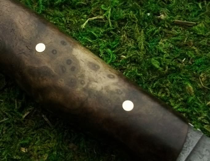

BTW, I FOUND THE DAMN WOOD THEIF, HE WAS HIDING IN MY WALNUT!!
BA, that's some spooky s*** right there. Took me a minute to figure out what the heck you were talking about, then had to look twice at the handle to see it, but damn, that's insane, brother . . lmao . . . . :D :D
