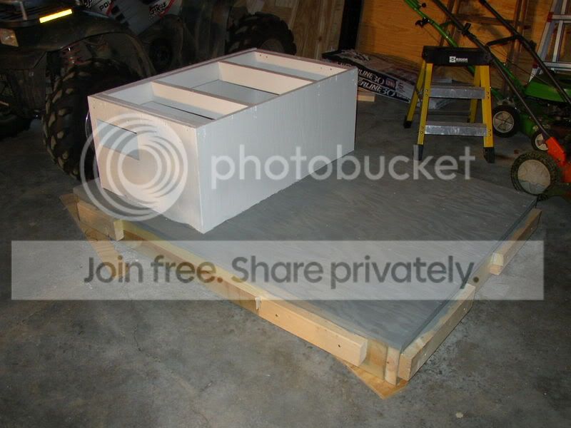

This is the base with the box being painted. I put 3 coats on the box and there will be 2 coats on the floor. It is a high quality oil based enamel paint.

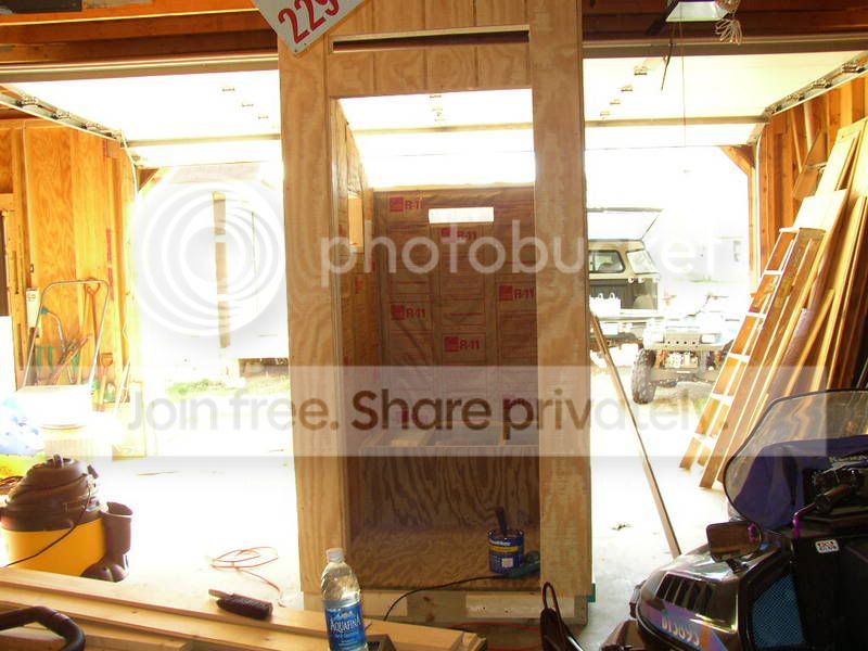

A shot of the insulation in the walls.

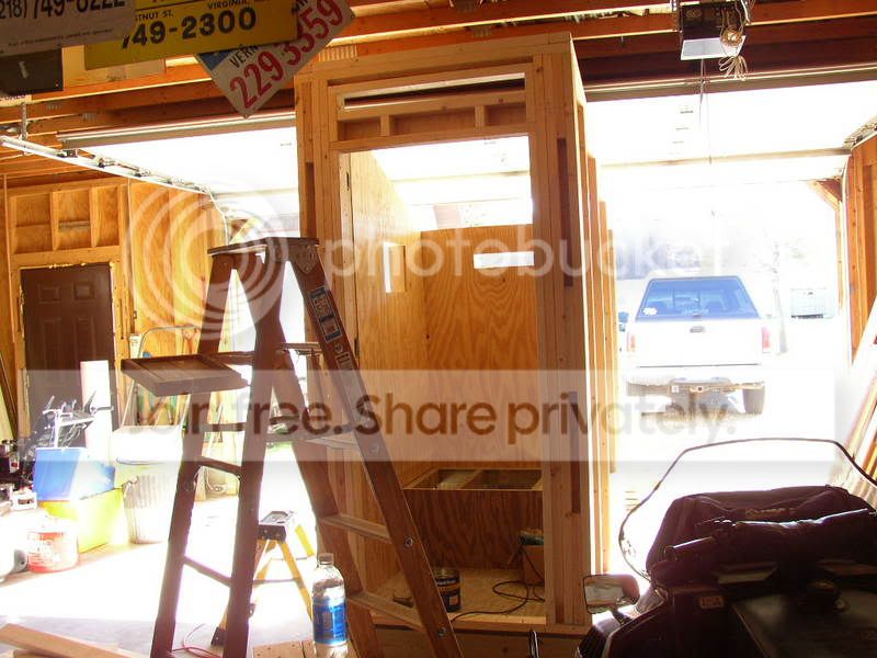

The plywood interior.

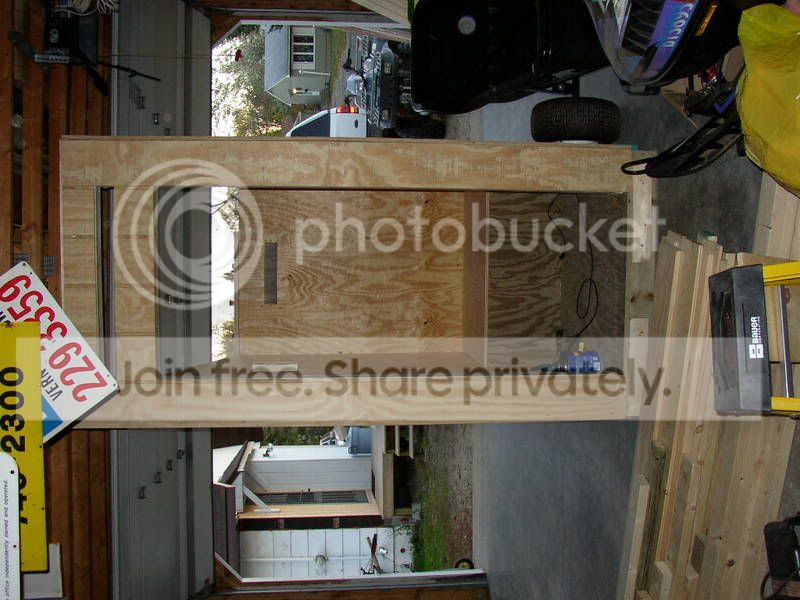

Seatboard prior to hole being cut.

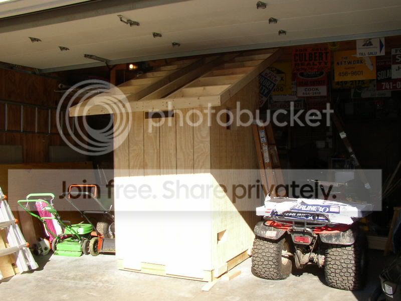

Here is the roof framing. I installed the sheathing, and moisture barrier on site after we got the roof framing nailed in place.

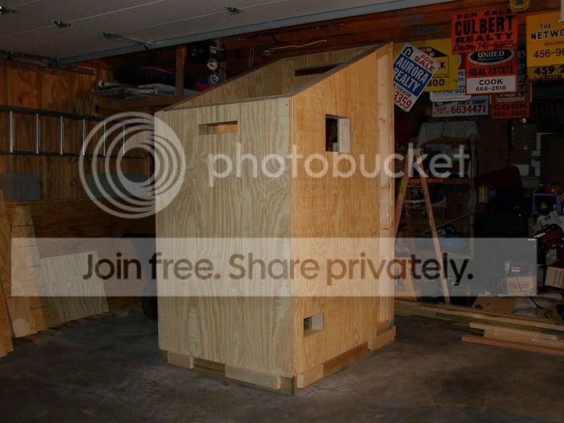

The whole thing went up well on site. The walls had the interior and insulation in them, and we just slid them into place, screwed them together from the outside, put up the T-111 siding and screwed it in place on each side, then the roof went up. The door and the soffitts went in on another day along with the window and vent screening.
