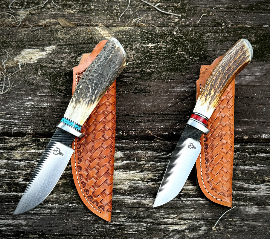

I use elk antlers on some of my work, but only the brow tines, what us elk hunters call the ones and the twos, or the fronts. If it has the right curve, I can use the third point too. Elk is pithy, and you can hardly ever make one into a good set of flat scales, so I sell the rest of the antler to a friend in NC who converts them to those high priced chew toys. My lab loves em too.
Very rarely can I find a suitable whitetail antler for a handle. They seem to walk (shrink and swell) even when dried out for years. Mule deer works,for me, much better for some reason

Some elk fronts here:
Both are beautiful, but the one on the right is exceptional.
Yeah the one on the left, the antler was just a smidge too large. But I finished it as best I could and someone loved it.
I was impressed by the stamping on both sheaths. Excellent mositure control and very uniform stamping
