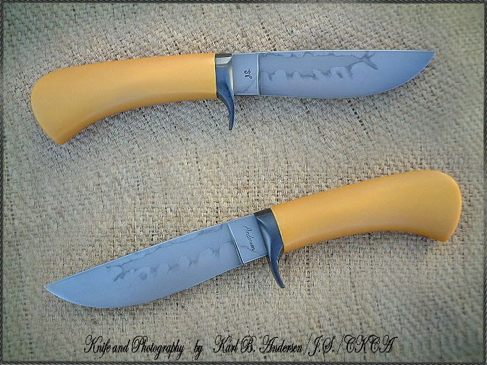

Does anyone have a pic of a hamon they've tried with their round w1?
I'm just wondering how much it differs from place to place if at all.
If you are just looking to try it, there is W1 on Amazon with free prime shipping. I haven't tried it yet, but I've been contemplating buying just one round bar off Amazon to try out and see how I like it. What I've found most places I've looked is you need to want to buy enough to make the shipping worth it. At this point I'm still just in the trying a bunch of different things to see what I like, so I don't want to buy a bunch of anything yet.
Thanks Karl, those look fantastic!
