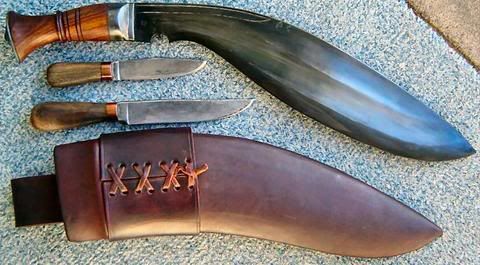

I used some copper tubing that I flattened slightly on a couple of kardas I made for my full sized Foxy Folly. Only trouble is they're open on the bottom. I solved that problem by leaving about 1/32" or so overlap at the bottom and filled that area with fine sawdust and epoxy when I was close to being done with them.
The nice thing about the sawdust and epoxy is that it completely seals the area between the handle and the blade!:thumbup: :cool: :D
I don't know how well you'll be able to see these but at least you can see what I mean about flattening the copper tubing. :)

normally 'bolster' is used here for the brass 'ferrule' used to cover the blade/handle junction as on some knives they may be integrally forged along with the blade rather than as a seperate item, it's a more generic term. the bolsters on many khukuries is not there for structural reinforcement and some do not have one.
the copper bolsters shown on the auxilliary knives above are also ferrules as they also are there to prevent splitting. i think of a ferrule more along the lines of those on hiking sticks, ice axes, etc. where they are there mostly to reinforce rather than to cover the join.
either word thus could be used, tho for clarity here i'd guess most people would use bolster.
