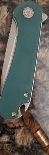

You should just dye the scales. Look at the YouTube from bladehq where they use fabric dye. Your scales are perfect since they are so light. Look at how I Dyed my version of your knife.
Do you happen to recall the name of the color you used there? I have an upcoming Rit dye project in the works on another knife and I'm looking into my options.
Ya it was the tropical teal. It looked so light but when mixed with my jade scales they came out as you see...the Kelly Green color. I recommend leaving them in the boiling water a bit longer for darker colors. I was worried it would melt the G10 but has always seemed fine and I always wish I would leave it a bit longer! Good luck!
