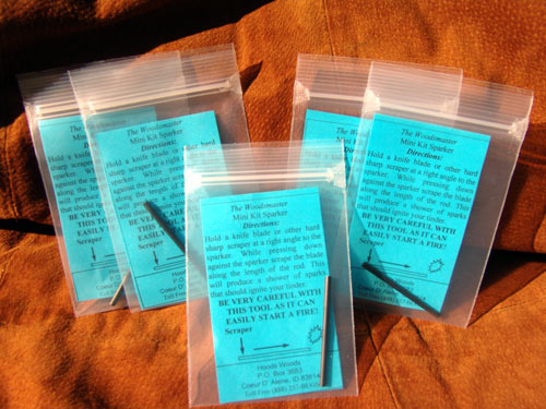

OK since we're showing pics :) Here's my spark based firestarting kit. As you can see, I was a big fan of the Magnesium bar until I learned how to ignite birch bark with the firesteel (see the second attached image for an animated sequence of me testing with birch).
I received the little sparker when I bought some Woodsmaster tapes from Ron Hood in 1999.

Nice pics Myakka and Ryan, practice makes perfect hey? Are those all yours?
