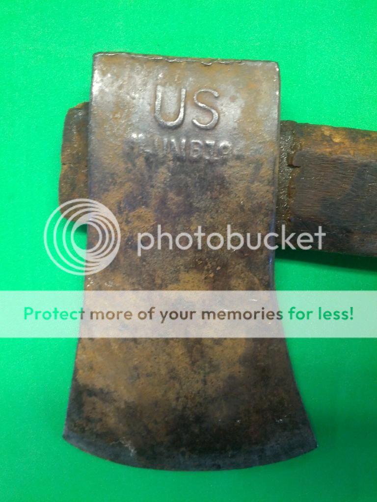

Hi folks, I have a question you more experienced fella's might be able to lend me an answer. I am about to take on a project or 2 - I'm gonna build up a couple hatchets, and neither have a handle. Now I'm not looking for the absolute cheapest bottom dollar one, but rather a decent quality stick of good hard wood. Where can I find such a thing, and how do I know what size I need as far as the hole in the hatchet goes? I am new to this department of the "knifenut sickness", and I'm rather excited! I plan to use these hatchets come next month when I spend a week up in the Rockies camping with my pa. I'm sure I can search around and find out how to properly mount the head to the shaft, but of course if anyone has any good links I'd appreciate it. Mainly I'm just after a good shaft, and I can't find one anywhere here where I live. Thanks a lot guys..

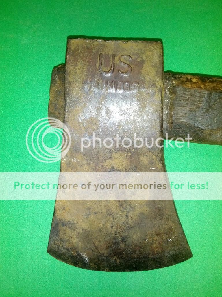

Oh, I'm thinking about picking this hatchet up at a local pawn shop. It's old I do know that, but do you think it's worth 35 bucks? I'd like to make it a project hatchet..and any info on this thing would sure help too..

$35 seems a bit steep for that. I'm not familiar with that particular stamp but there are many top quality hatchets and axes out there for half of that price. Shop around.

I don't doubt that. On the other hand something unique that catches your eye and fancy has intrinsic value only by virtue of not having to devote many more hours in scoping around for something cheaper. Staying away from an evening's revelry at the saloon will easily negate the desire to 'nickle and dime', and might even buy quality time to re-haft the old girl. I say plunk a $20 down on the counter and see what happens.
