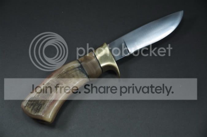

I am a big fan of Ed Fowler's knives and have been looking for a good source for sheep horn for the handles. I've had a few sent to me by a friend but I need to find more as I am out.
I recently made this knife for myself (that's why the finish is a little rough :o) and I really like the feel of the sheep horn handle. It's something I'd like to explore further.

That is a sweet looking knife Stuart!

Stuart, did you know that sheep horn in a knife handle will absorb heat from your hand and have warmth in it to provide a little comfort when using it on a cold day? Frank
