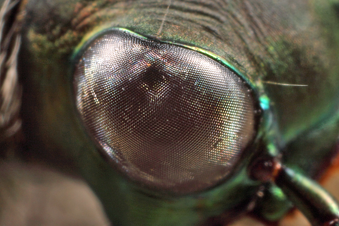

Here's a photo uncropped using this lens with a single extension tube of an insect eye for reference. Obviously not the same as a 5x loupe.
Ken
Here's a photo uncropped at 1k x 720 pixels using this lens with a single extension tube of an insect eye for reference. Obviously not the same as a 5x loupe. My pictures were shot at full resolution (5k on the long axis) and then cropped from that image.
