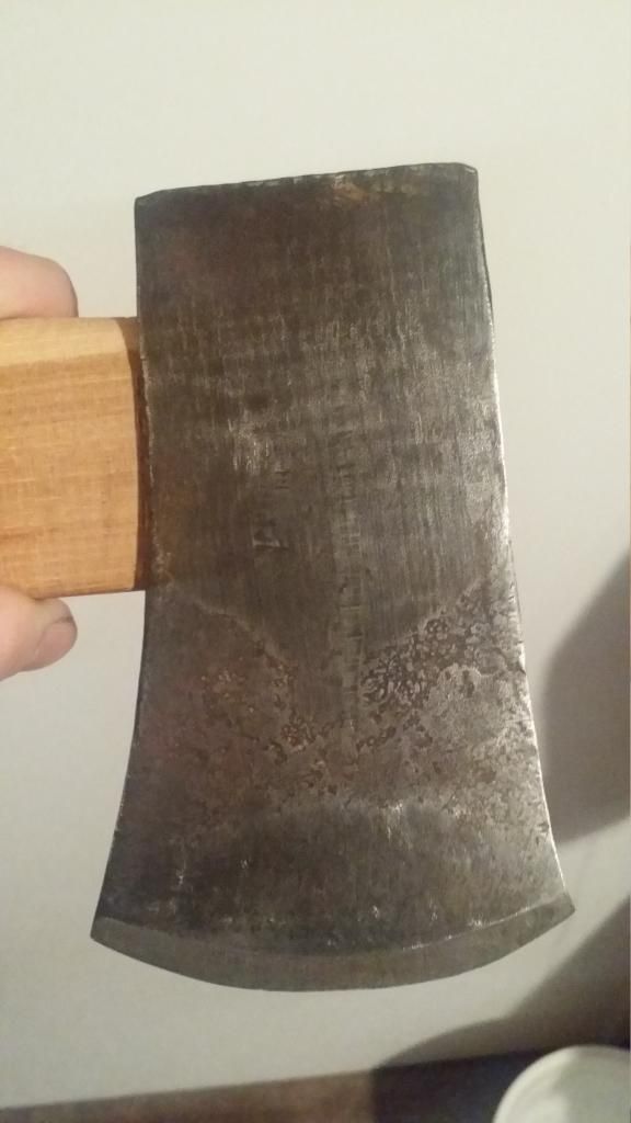

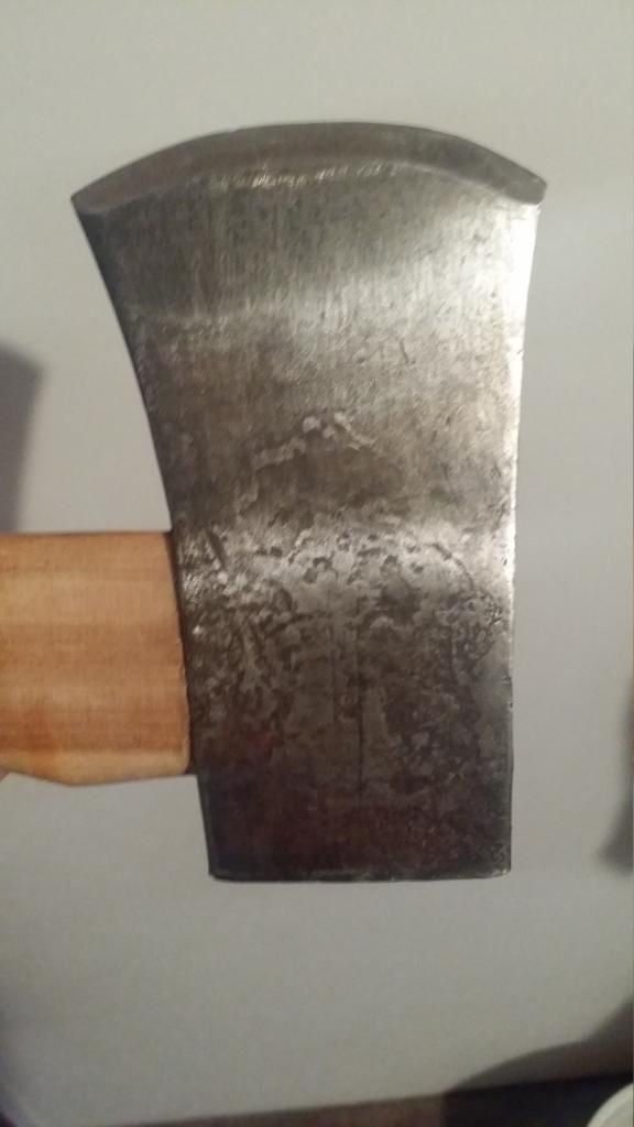

I have a full sized American felling axe head that had been in the family and I have rehandled it, and a boys axe that I also rehandled. Couldn't find signs of a maker on either. The boy's axe is terrible at splitting, but I think it needs a major reprofile anyway. I'll try to post a pic. With all the vintage and American references, I'm guessing the Euro axes are not as head-and-shoulders above the rest as people make out.

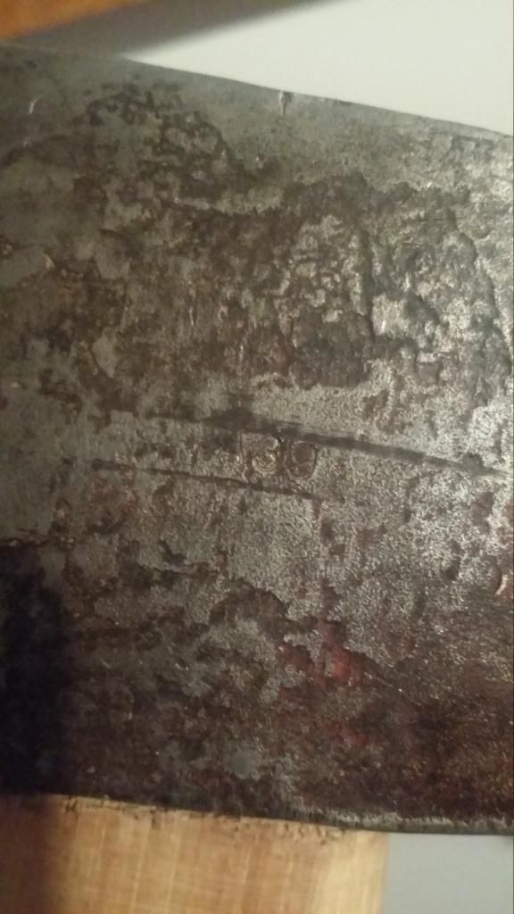

I think this is a Kelly/True Temper because of the "A39" which is the only visible marking. It's a pretty fat axe in terms of width and the bevel.
