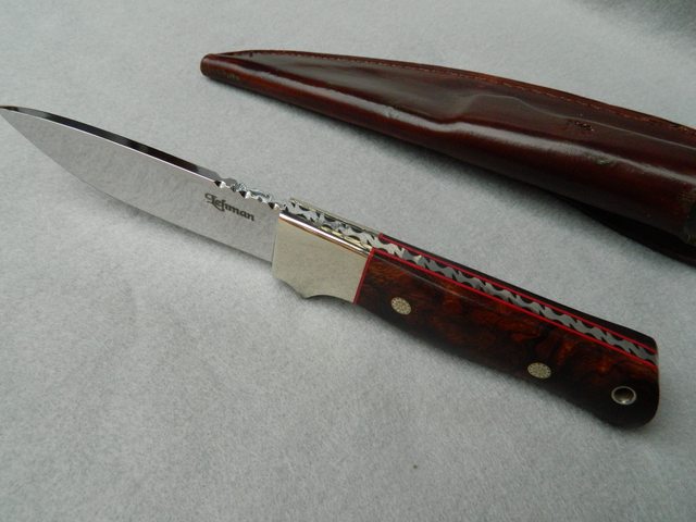

Holy crow Larry, by the looks of that knife it seems you got it figured out.
I have been using K&G green compound to finish high polish blades and I also use #51 white compound from Texas Knife Supply which is supposed to be around 1300 or 1400 grit. The K&G compound gives a nice finish. Is any one using a compound that they like better for high polish. I hand sand to over 1200 grit before using the buffer. Thanks for any suggestions, Larry
It's hard to judge a mirror finish by a small photo. You just about have to have it in hand.
