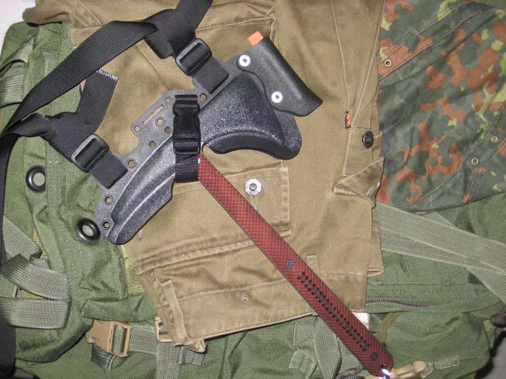

I like the Kestrel for its size without compromising the power. The head is exactly that of Talon but packs a stealth yet nasty punch outta sheath.
This is how i would usually carry it; underneath the arm (Thanks to Etwood7, he made it looked really cool yet practical) or in front of the chest if i'm carrying a backpack.
