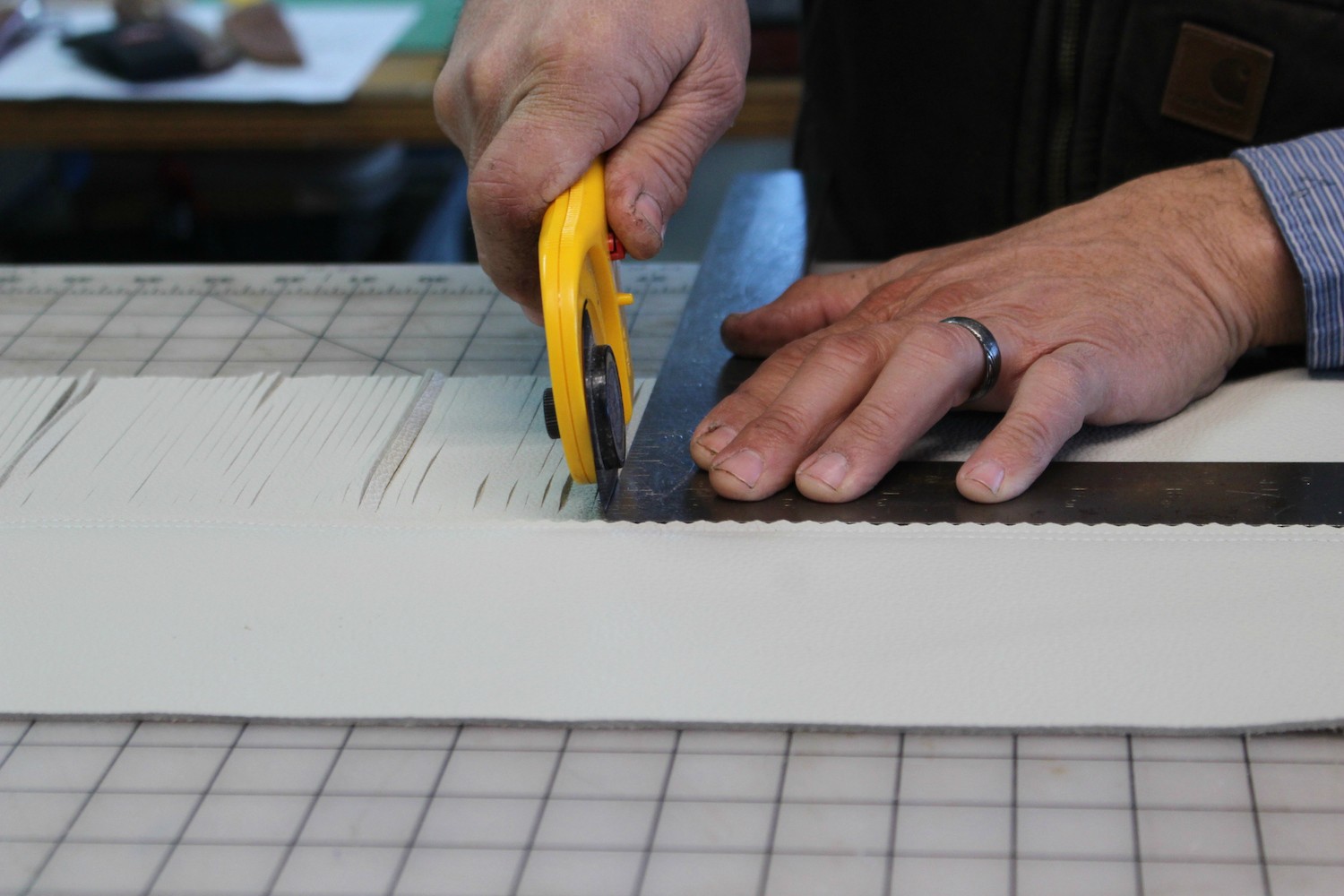

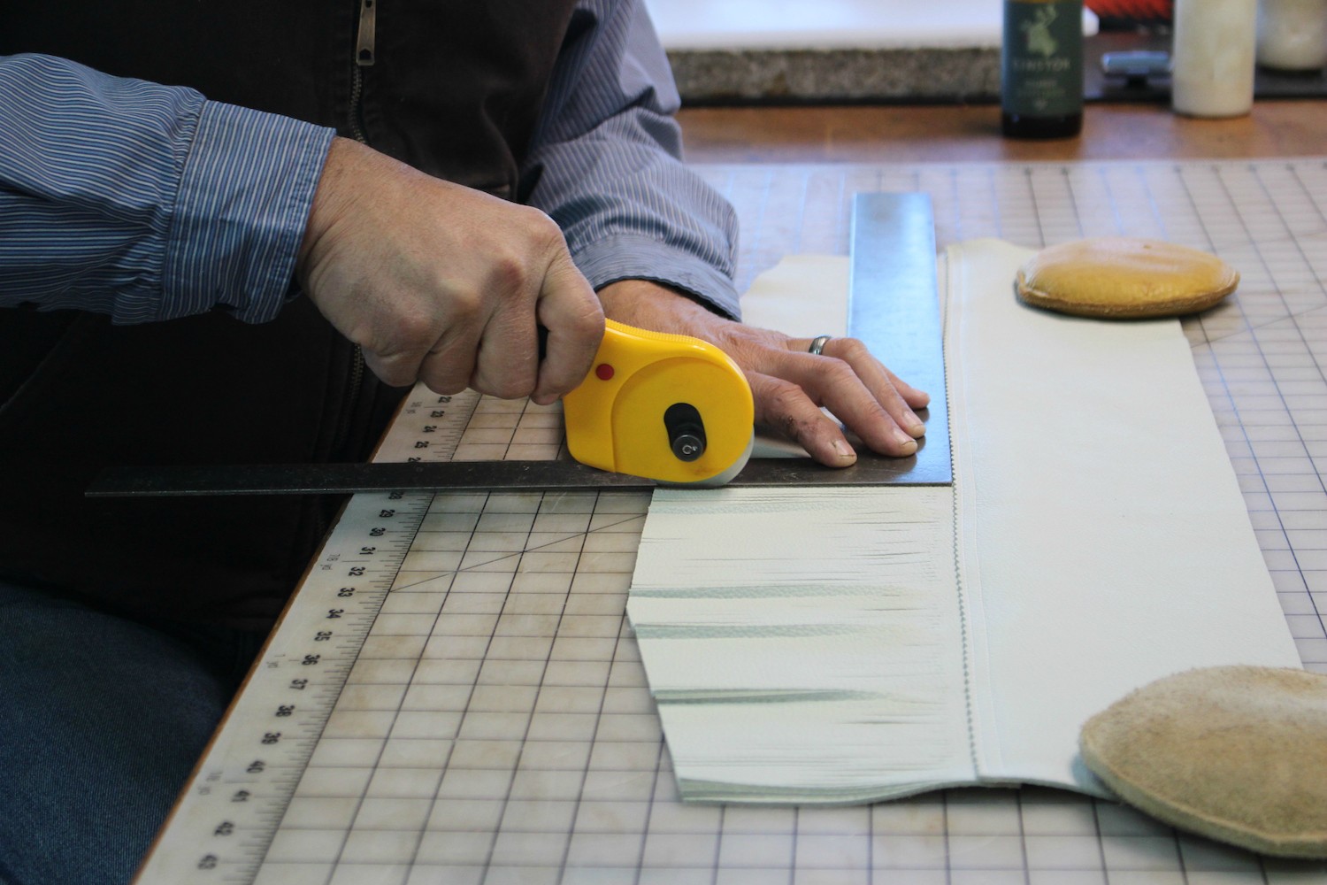

Here's a couple of pics that shows you how I cut fringe. Finished these off just before Tday.

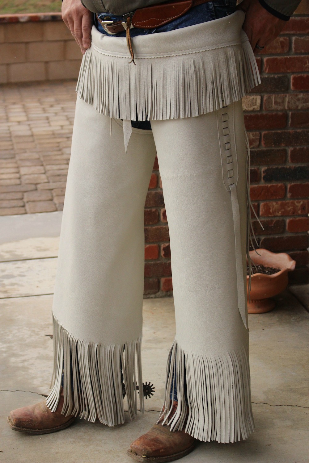

The straight edge allows for consistent length (although here I have a sewn seam to act as a guide too), keeps the fringe perpendicular to them selves, allows consistent width and also protects your fingers. This is the waist apron on a pair of my charmitas.
Make up a couple of pair of these and a guy can get handy at cutting fringe. many old timers would cut fringe with a roundknife or scissors. Having used both of those for fringe cutting I'm here to tell ya one of these roller knives is the way to go.
