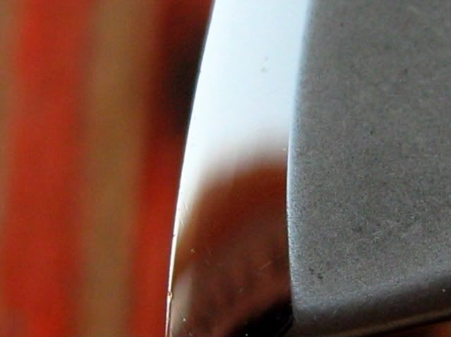

I can start getting a mirror polish from the fine and the UF will make it almost perfect. After that I use 1 micron diamond compound on a leather strop to make it a true mirror polish. My UF stone has been resurfaced by spyderco and is a little finer than standard (around 10k is my guess) so the polish is a little higher but this is close to the results you would get.
Though it looks good if you look closer you can see all the fine lines made by the stone.
To reach a true mirror polish you must use polish and when you do it looks more like this.
Sorry about the poor pic its very hard to take a close up of a high polished edge.
Very nice pictures knifenut! No need to be sorry! Did you do those edges freehand? Wow.

Thanks, yep all freehand. I use my aligner sometimes when I'm lazy but 99% of the time its freehand.
I should also say that in the last pic the finishing stone was a DMT XX fine before the strop and not the uf ceramic like in the other pics.

Here are some terrible pics of Shapton 8000 grit edges (1.84 micron). For reference, the Shapton 2000 is already starting a real nice mirror before I finish with the 8000 grit. All of these edges are freehand.
Nice pictures, gunmike! If Shapton 8k can do that, then 16k should be wicked sharp! I want my knives to be as sharp as my razors, except hold a stronger, harder edge for heavier work.
Judging by the pictures, your edges are even more acute than mine! I use edges down to 16° degrees inclusive, and you've got an even wider edge on the same knives.
