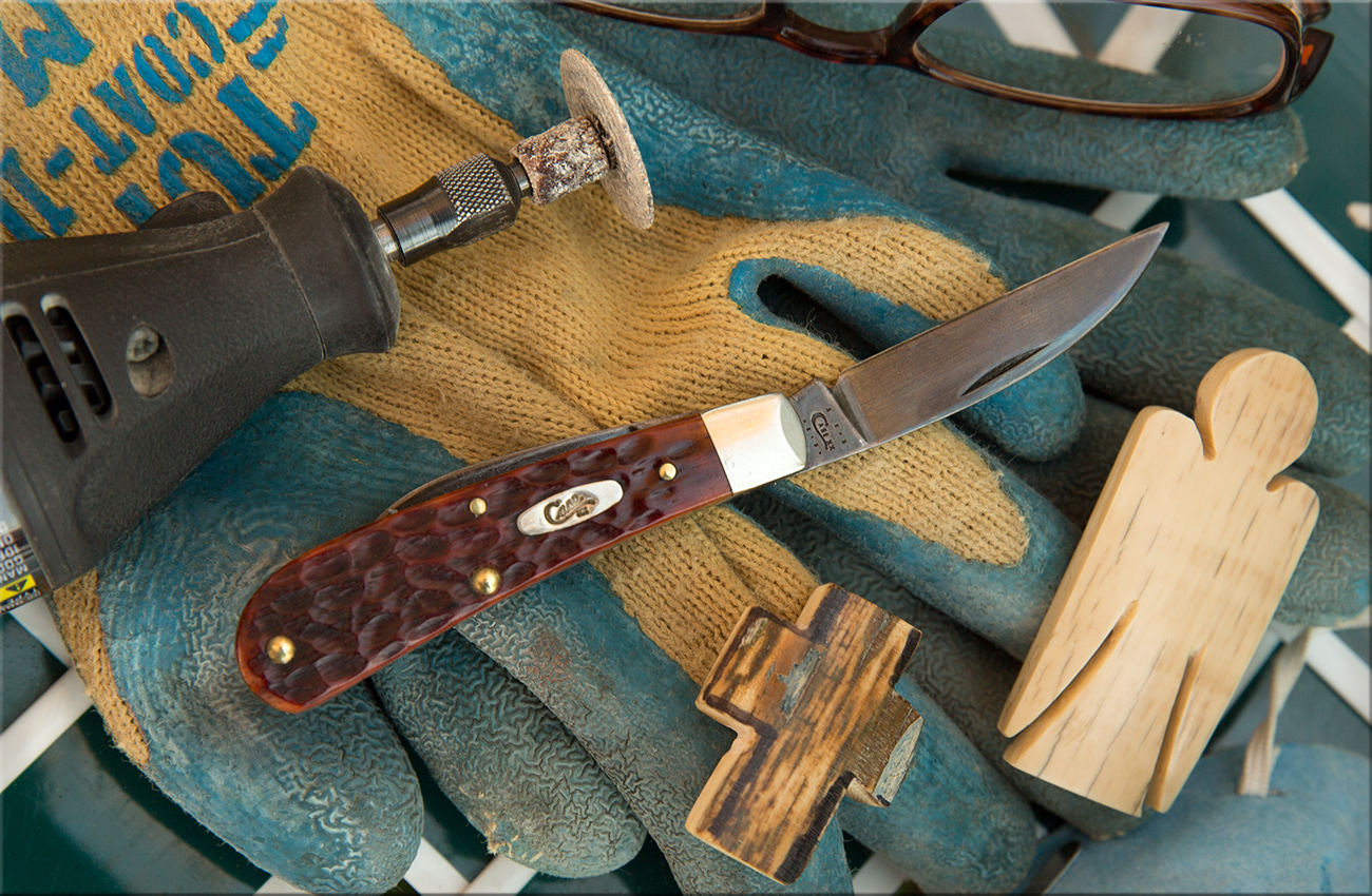

Welcome aboard Bob! Sounds like your more interested in Case. If you get the CV mentioned and use it quite a bit it will start looking something like this...
Have played with the patina on this CV swayback, tried many methods before deciding I like the colors made by Blue Wonder. That said, after carrying this knife for 6 months am ready to put it away, carbon steel (even D2) rusts in my pocket, imparts a metal taste on food, and the stropped area rusts in minutes if not wiped and dried. Am going back to stainless.

Hi Chief, nice swayback and you did a good job on forcing the patina. Rust can be problematic from time to time from what I am reading. I do not use my pocket knives for food purposes, so the taste of carbon should not be an issue in my case.
