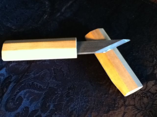

Any thing with a straight short blade is going to be easier to sharpen
top knife = Cold Steel Tuff Lite (mini in this case)
This one is single bevel (the back is flat) so even easier to sharpen than the rest
this blue Case Swayback has one straight blade. You can get it with just one blade.
How would I sharpen it ? I am going to be a chicken shed and say : Well I would put it in my Edge Pro and kind of brainlessly move it back and forth a little and it would come out jaw dropingly sharp.
