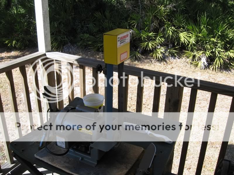

I use the Kalamazoo 1" x 42" sander. It also works on cheap knives.
