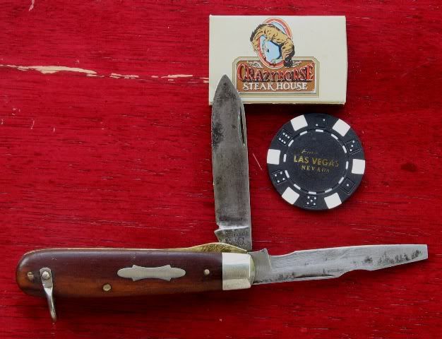

There is a liner lock in some electricians knives to hold the screwdriver and wirestripper blade tight.
