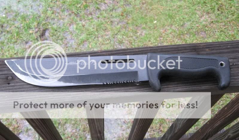

This hideous knife has proven to be very tough. I have done a lot of chopping with it and even like to stick it in trees. It's a beater. Edge retention is not great, but good enough for a machete. Steel? 420J2 :eek: Surely not the toughest I've ever used, but tough. But I want tough with edge retention. So I buy Busses.
