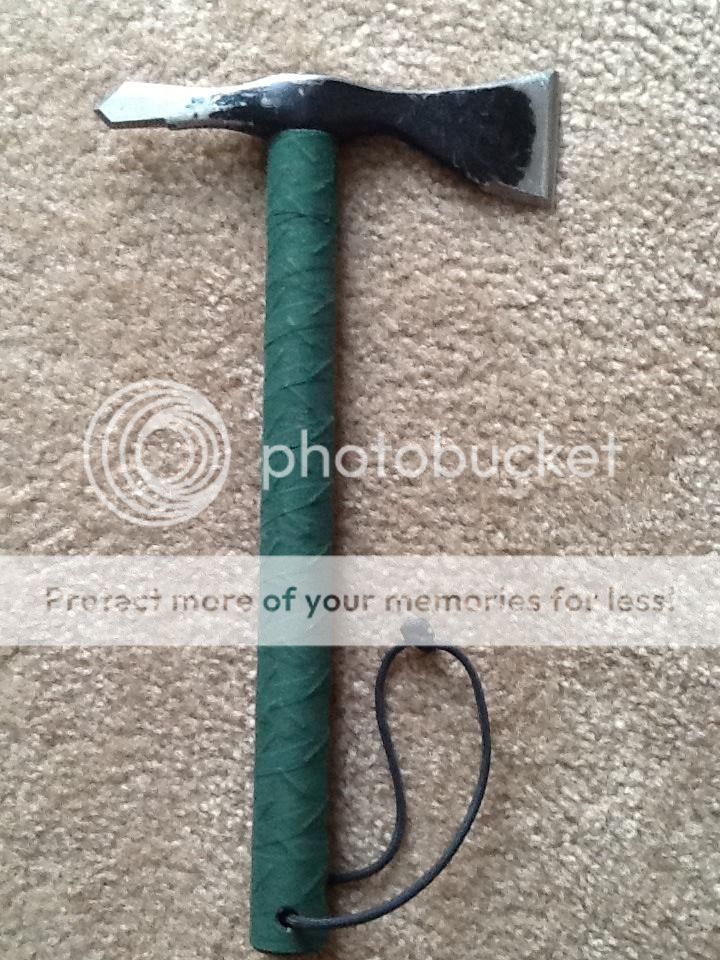

Have you thought of a Swamp Rat Rattle Hawk? I really like mine.
I did not look at the rattle hawk but I did look at the swamp devil and I determined that it seems functional but something about the looks just turns me off. the flat look doesn't appeal to me. It looks like it was just cut out of a press. Tell me how durable has the rattle hawk been. have you tested it and on what media and how has it held up.
I honestly haven't put mine to the test, just lots of wood and one cinder block :D It held up great. But, there is a LOT of evidence of SR101 holding up to some serious abuse over in the Busse sub-forum. One member cut a car in half with his Kill Devil hawk, there is thread complete with pictures and videos if you want to check it out.
