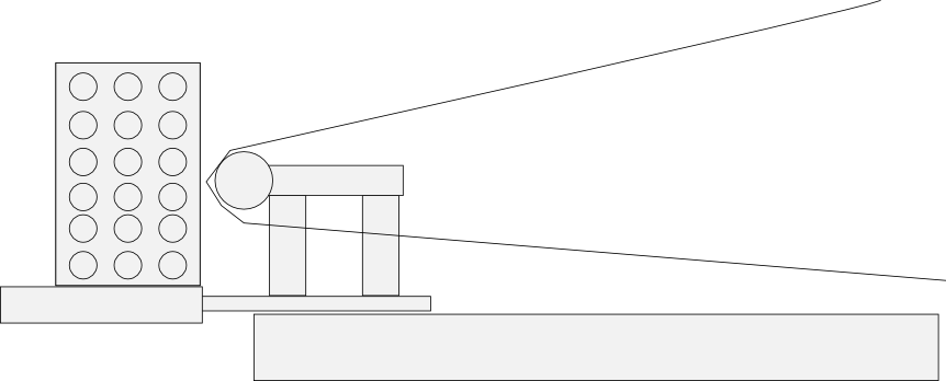

Completely skimped over those on beaumonts web site. This grinder really does justify its cost. The only thing I see with that is how would you keep the work piece flat when grinding since there is no table to rest it against? It seems since you have to do it freehand without support that you wouldnt be able to keep the knife straight and when grinding along the wheels you may lean a bit and the knife edges would be uneven. I looked over it a few times and dont see how you could make a jig for it either.
I would say you could get it close and then finish it by hand sanding but the problem still lies with how would you get the edges flat? Even with a dowel or similar you cant keep it perfectly straight which would lead to the edges being uneven.

You may be right, I forgot that the work rest on a kmg would be level with the small wheel... Ok, here's an idea: Where the small wheel holder bolts to the tool arm, if you used longer bolts (like 5" or so) and a bunch of washers you could bring the small wheel to above the work rest. Then you could clamp your 123 block vertically to the work rest and move it really close to the wheel and there ya' go!
Like this:
Like this:
Ok I got the idea now. If you ever come across that video of snody using that jig again send me out a visitor message with the link if you dont mind. Would like to see it in action. And out of curiosity how would you clamp that 1 2 3 block to the worktable without having a hole in the worktable? Never used those blocks before but they seem like they would be useful.
