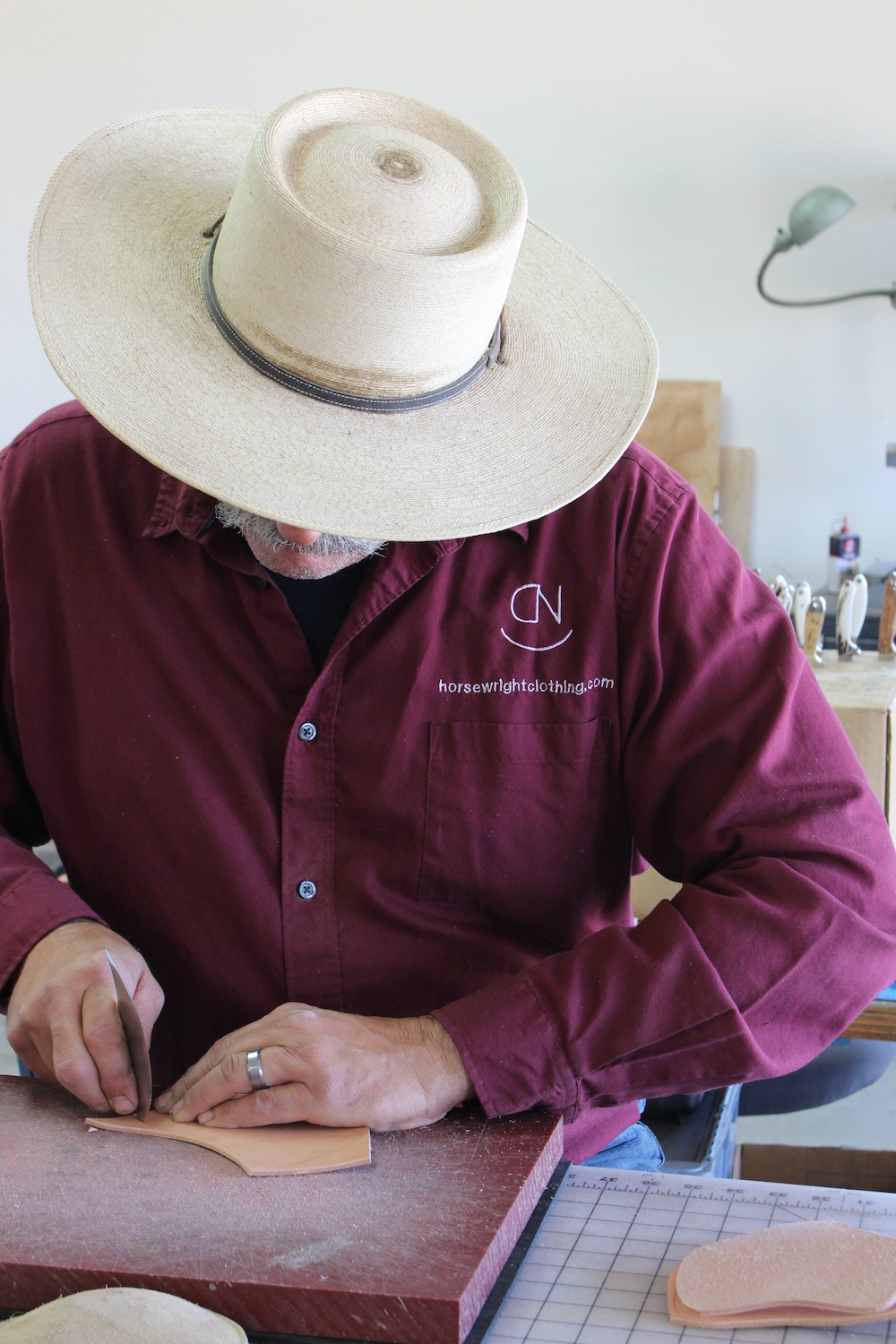

I ended up using one of those Hydroma cutting boards that Tandy sells and available online other places as well. The poly boards didn't work too well for me as I would cut through the leather and get the knife stuck in the poly. With the Hydroma the blade cuts through the leather and doesn't get stuck. Kinda skates along. I know several saddle makers that cut on those roller mats that I have under the Hydroma in this pic. I can't even begin to do that I get stuck right now on one of those. I learned about those Hydroma boards here in Sheaths and Such so ya can teach an old dog new tricks.
The Poundo board under the cutting board help keeps it still and from moving around while cutting. Cutting out some Leatherman sheaths here.
