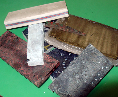

Hi
I am making a wedding cake server set for my wedding and I want to use a hidden tang design. I planned on using white corian but I can't seem to find any that is thick enough, all I can find is scales. Now I am thinking of making my own micarta by layering white with turqouise. Turqouise is one of our wedding colors. I know somebody posted on here about how to make it, and I can't remember what kind of resin/expoxy I should use. Does anybody know what kind and where to get it? Or do you have any other suggestions for a good handle material? Thanks in advance.
Adding this on because I forgot....
I am thinking of doing the damascus micarta, where you twist the material. I was wondering how I should compress it since I don't have a hydralic press.

stabilized bone handles
i think ariel saliveria has a tutorial on making micarta. use the search option.
good luck, post some pics when you're done
you dont have to have a press but it is nice as i have just got myself a 12 ton :thumbup:
you can use a bunch of C clamps
the epoxy i use and that seems to work well is Envirotex Lite Pour-On Finish

How does that Envirotex hold up butcher_block? I like the fact that it is clear, I wish the stuff I was using was more clear. It is very tough impact resistant epoxy but is a amber color when mixed. C-clamps work fine. I use either two 6" clamps along with two 8" clamps together or I have set up that is 4 clamps that are all 8".

so far with impacts it holds up well its made for bar tops so that makes sence
i still need to do some dishwasher testing and some other places my stuff should be put but need to make sure of any how

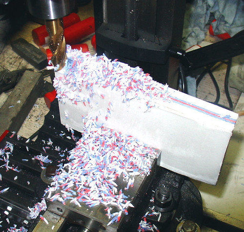

i ll post a pic tomarow of me milling some but 24 is getting ready to come on and i got to get home
butch
i did use the press last night again and boy do i like it better then the C clamps i do have to tune the setup a little but it works well as is
and some pictures
