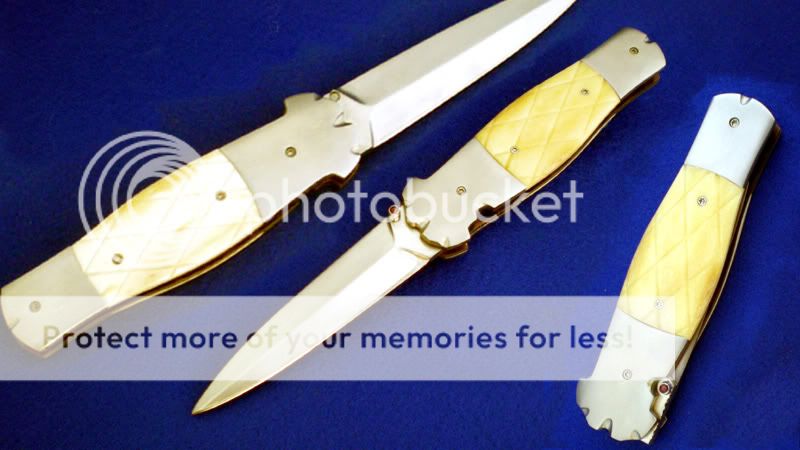

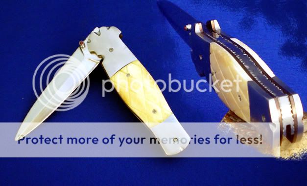

Total liner lock measures 20 cm 9cm blade 4.5 mm thick concave and satin grinded to 800 grain, used steel ATS34, folders, anodized titanium, firm in 416, worked bone grips with diamond pattern, screw opening (cut from a piece ATS and turned to drill files) steel and ruby (small but true), files on the back and the blade.
a cordial greeting to all hello
That's a good looking knife, I really like what you did with the diamond pattern in the bone.

a big thank you liked it Xaman
Well done looks nice:thumbup:, small folding daggers are one of my Fav"s.I doing one at the moment
