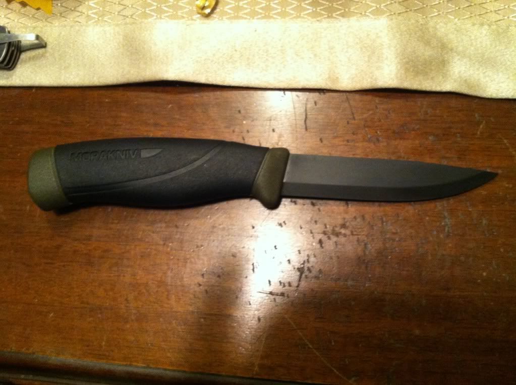

Clean the blade with rubbing alcohol first. I used apple ciudad vinegar heated in a glass in the microwave. Then dunk the blade in there. Try to measure it so the handle stays out of it. Let it sit for about 10 minutes and then reheat the vinegar. Repeat. I did my Mora like this for about an hour. On the last time, immediately rinse it. I used a blow dryer to dry everything and then I rubbed mineral oil on it. A light polish with silver polish will lighten the color a little but it cleans a little bit of the "soot" off.
Heating the vinegar will give a darker appearance as shown above.
I typically do a paper towel wrap.
Often I will take a q tip and heated vinegar and repeatedly rub and rub again and again. You can get a very dark even etch like this (assuming you have a clean blade to start with.
