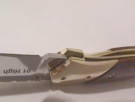

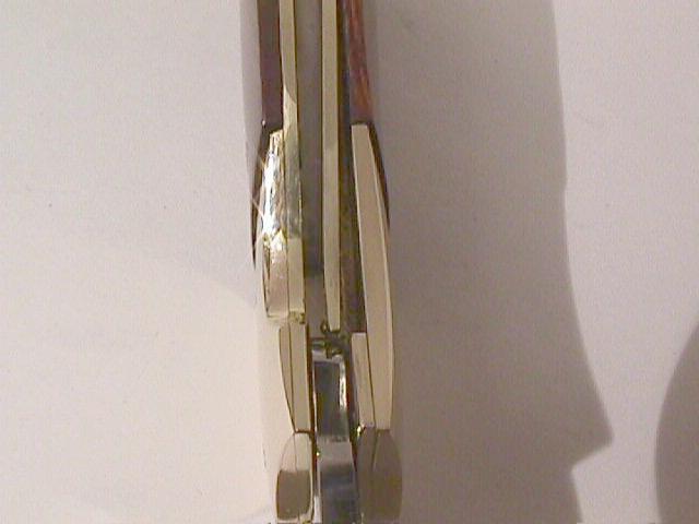

I was just wanting to know how many of us on here make folding knives. Also have you ever ran into this problem: the handle is to fat and for the blade. The knife in progress right now has aluminum liners and brass bolsters with some 2 color dyed wood i picked up from the last knife show i attended like 2 years ago. I like the feel of the handle but it just dose'nt match the blade i have on it and there is no going back now because all the folders i make have different lock sizes where it matches the blade. If a big handed man gets it he might like it the blade falls just under 3 inches. its going to have a pocket clip on it for tip up carry and the openning design is a claw type peace that opens the knife when you pull it from your pocket.

when I have time.. :)
this is one I put out..
