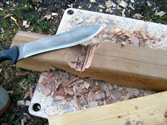

I can't let this thread go by without post a pic of my Outcast. Several, I'm sure have seen the pics already, but they just have to suffer.....
Knifenut was right about stripping the coating, it does seemed to make the knife stick, and with the minimalist of care rust can be avoided.
I achieved my results with a combination of belt sander, Dremel sander, wire brush wheel, buffing wheel with polish compounds, and a set of paper wheels. The end result is a large, razor sharp, wicked chopper. The orange pic I took one day after being board from being snowed in. I wanted to see how my new edge would do slicing an orange in mind air. I thought I missed the orange until I saw to halves hit the floor.
Has far as the grip goes, I like it myself, I only wrapped it to absorb some vibrations, add a little girth, and to have a little para-cord in case of emergency, but really, it would have been fine without it.
There have been some other good options suggested, but none of them will hold there edge like the Outcast's D2.
