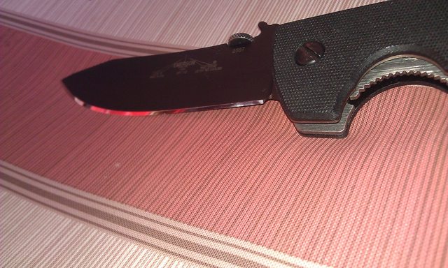

That, plus the fact that they are a pleasure to sharpen. Sorry about the bad phone pic. But this 8 is crazy sharp after some time on the Edge Pro.

Nice edge indeed. I'm debating whether or not to put an edge like that on my 15.

Rev - what edge angle are you using for your blades? I'm assuming that you work on the one sharpened edge till it's where you want it, then are you just more or less knocking the burr off the back side? This is what's giving you that edge?

I do the edge as I would a normal edge, but as you say, just knock off the burr in the straight side.
So I would start with around 20 or so strokes on the edge, then one stroke on the ceramic rod for the straight. Working my strokes down from 20 then 15 then 10 then 5 light. Again, after these only one on the back with the rod.
I sometimes use my Sharpmaker, fine stone on the 30deg. for the burr stroke.
This one I finished with the 1000 grit stone, and then the 2000 tape on the edge pro.

I've used the Edge Pro to match angles on a CQC7 from 2004 (my first Emerson knife). It worked really well. Before I got the EP, I used the Sharpmaker or freehanded on stones and automotive sandpaper on a piece of glass. Lots of ways to get a killer edge on any knife. The best advice I have is, do not overthink it. There is 1 bevel, 1 angle.
You can truly get away with freehanding on some inexpensive sandpaper and glass, and you will be very happy with the edge. Put some Sharpie on the cutting edge, before sharpening. When you take the entire marker line off the bevel, you are hitting the angle just right.
Knocking the burr off is tricky for some. What I do is cut into a piece or 2x4 as hard and I can (slicing motions) several times. That has taken the burr off immediately. Or you can use a ceramic rod/bottom of a coffee mug, or a strop.
