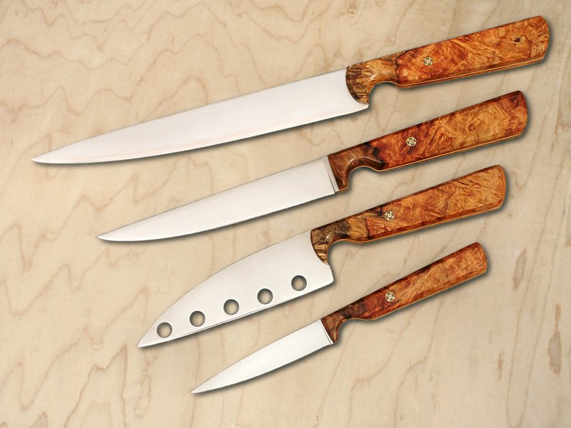

Chris,
Here's a set of kitchen knives I did. Grant you the handles do NOT look usable/comfortable. Oddly enough they are very versatile and comfortable (so the owners tells me).
It's not shaped like a hand at all and the edges are more beveled than round.
However, the bevel gives a secure feeling and a sense of up/down VS. a round handle. The finger groove for the index finger rarely sees an index finger. It ends up being more of a grip point, or used by the middle finger.
This wasn't a plan. It was just something that turned out to work, but doesn't look like it should.
Steve

I really like the handles on those kitchen knives and the blades...superb. Slightly OT, but can you post another explanatio on them...why the holes on the one blade (it is very pretty). I do like the handle shape myself and tend to like more "square" feeling handles in my kitchen knives. gives me a sense of leverage and control...

The pics don't show it, but the handles on those kitchen blades taper from the butt to the 'bolster'. That's another handle shape issue that I think is necessary for most applications.
I'm really thinking about what Scott said about thickness. I tend to use 1/4 material for slabs. Now I have to rethink that!
Steve
PS Tarl, The blade holes were there because I don't know how to do scallops. The idea is to reduce suction and make cutting sticky things (like cheese) easier. I told the customer if he didn't like I'd replace it. He liked it just fine.

Steve - actually, I think those handles look very comfortable (and the knives are absolutely gorgeous, by the way).
