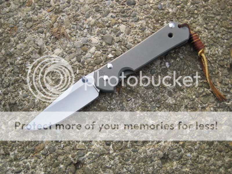

Raise your hand if you don't enjoy an Edgepro'd Sebenza....

I love 'em almost as much as I love my Wicked Edged Sebenza... ;) I will say that when I took this photo, showing the mirror polish wasn't my objective. While it doesn't have that look of showing a reflection, it's polished down to 0.25 micron diamond spray level and is very shiny.

Beautiful, both those sebenza's are absolutely beautiful and the shiny edges make them look like they're ready to serve there Masters.
Good work. Few knife-related things more rewarding taking the time to turn a dull looking edge into a mirror. People gawk.
Very nice! What angle ya got on there? Oh, and did the thumbstub get in the way of sharpening the edge back near the ricasso?
I went with the blue line on the edgepro and layed the blade down off of the high hallow part, , so I'm not exactly sure what angle it was, but that's the angle it came to me yesterday, so that's the angle I sharpened it at. I just do the sharpie method to find the exact angle that it was originally set at, that way I don't have to lose too much metal.
