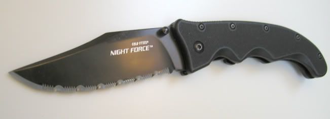

The Cold Steel Night Force, w/440A.

I've made it a point to use my Cold Steel Night Force plain edge over the past few weeks and my conclusion is, I love the edge I can get initially; it holds the edge adequately well in moderate use for a week or more, and it's easy to field sharpen.
Comparing it to my Spyderco Native (S30V), the Native clearly holds an edge longer, but I am unable to quickly bring the edge to a super sharp capability. Although the edge stays put very well, it doesn't hold a bleeding sharp edge very long. With fairly moderate use, the edge goes to a very nice utility sharp blade and stays that way indefinitely. It also can be easily retained with a little time on a Sharpmaker. Getting it to stay bleeding sharp depends on what one cuts with it and how good of a sharpener the owner is.
I've found it's easier for me to use the 440A or AUS8 blades and keep them sharp than it is for me to use the Native for an extended period of time, then try to get the edge back. Other people with better tools or skills may feel differently.
Another observation: the knives with the 440A/AUS8 category steels tend to have larger blades, which extends edge life, ease of cutting and, again, ease of sharpening. The larger blades are a pain for some people to carry, but they're good self defense and emergency tools—and that is a plus for me. Even so, a Native is a wonderful little cutter. Lightweight, durable, great blade configuration and the grip goes right into the palm. It can be pressed into service as a tactical or emergency tool. (Note: The 440A blades found on cheap knives is notably different than that found in the CS knives I've used.)
