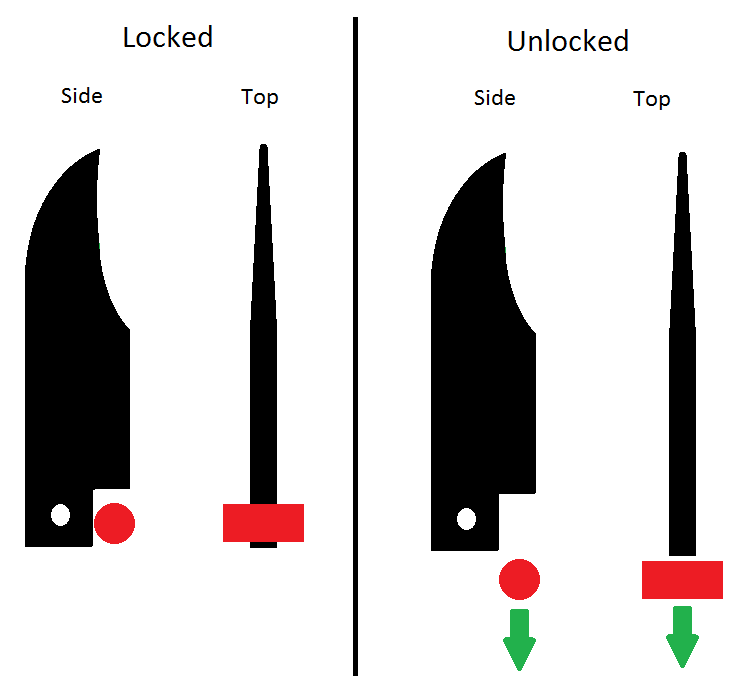

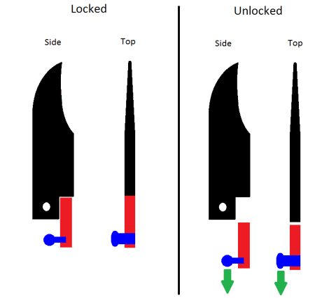

Here's my attempt ("attempt" being the operative word) at illustrating the two lock types and how they work. I may be mistaken, but this is what it looks like on the knives of the two types I've taken apart. All the Axis Locks I've seen appear to function the same. There are some variants of the Bolt Lock, mainly in where the springs for the bolt/release are, but they all essentially function the same.
Axis Lock - cylindrical bar (red) runs perpendicular to the blade tang and wedges it in place
Bolt Lock - bolt (red) runs inline with the blade length, and release mechanism (blue) is the thing on the blade handle you pull to retract the bolt

If this was for my edification, let me clarify: I wasn't disputing how the bolt action lock works. That part, so far as I can tell, you've got bang on. :thumbup:

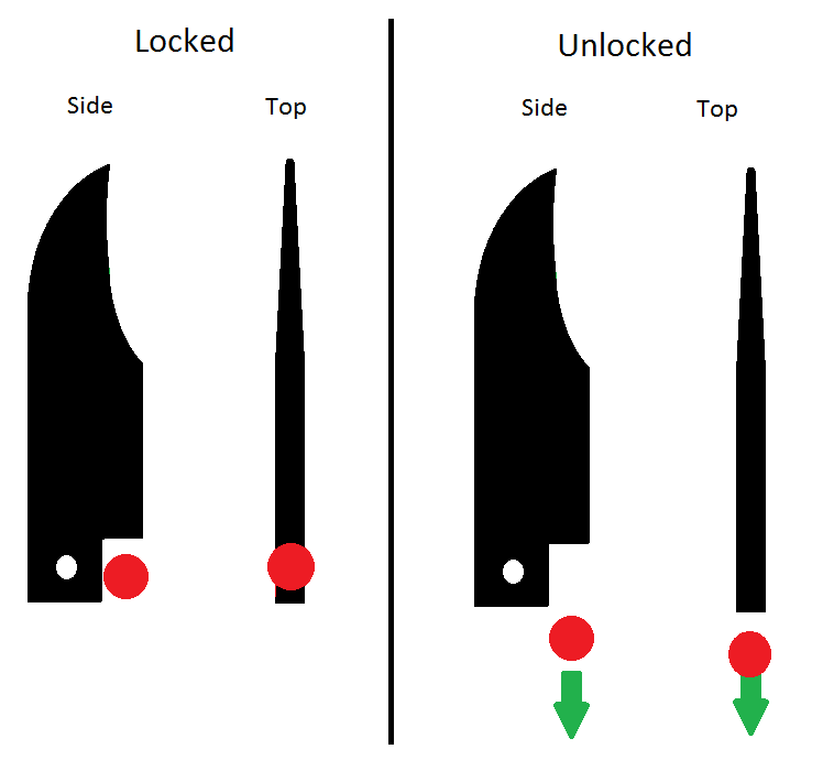

The Ball bearing lock, though, pretty much works exactly the same as the axis lock. When you draw the ball bearing back, it serves the same function as the axis lock's lockbar. Using your diagrams, this is what happens:
As the ball bearing is drawn back, it slips off the tang of the knife and allows the blade to close, in the same fashion as the axis lock's lockbar, in your diagram here:
The fact that there is a backspacer in place to prevent the ball from slipping out of place, as chiral mentioned, doesn't mean it isn't nearly identical to an axis lock - the backspacer merely provides the same support to the ball bearing that the milled-out portion of the liners provide to the axis lock lockbar. The difference is minute - in an axis lock, the lockbar travels along a channel cut into the liners. In a ball bearing lock, the lock ball travels along a channel cut into the liners, which has had a little roof on top.
...but that's all semantics. Like I said, they're functionally identical when it comes to the OP's concerns about actuation and safety. :thumbup:
Ahhh... I learned something new. I actually don't have any of the Spyderco bolt or ball bearing lock knives. From just looking at the pictures, I guessed they were just variants of the bolt lock. Functionally, the ball bearing lock looks like it operates on the same principle as the Axis lock, just a different implementation. Thanks for the clarification. :)
Not quite. The ball-bearing acts on the tang and the back-spacer. That backspacer is fundamental to the function of the lock, just as with the bolt-piston. The liners offer no support other than to prevent the ball from slipping out the sides, as the pictures presented clearly demonstrate. In this way, these two designs share similarities with back-locks. The axis-lock, on the other hand, does not rely on a back spacer but on the holes milled in the liners to keep the lock-bar from leaving the area, again as the above pictures demonstrate (and a note of thanks to Dorito Monk for their inclusion). Please note, I am not commenting on which design is stronger or more durable or more user friendly, just on the construction of each and what each relies upon for support. This is just for clarification of important differences in the CBBL and the Axis designs.
