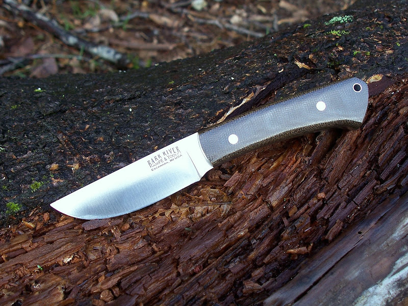

XHP Woodland Special.
I have used both the Highland Special and the Woodland Special for a variety of tasks over the years.
I found them both to be a lot of cutting power in a small package. :thumbup: :cool: :thumbup:
For me the handles are not an issue, the size seems in balance with the size of the blades.
Big Mike
Mike, those scales look noticeably thicker than mine, and would make a difference. Mind you, I have used my Highland for cutting wood, batonning, etc., and it works fine, I just wish it had thicker scales. The length is not a problem for me, but I don't have large hands. Personally, I think the handle length issue is overblown with this model, it fits larger hands than you might expect. It is a light, strong, capable blade. The A2 takes a very fine edge and holds it well.
