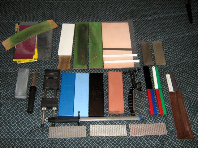

I do most of my sharpening with spyderco ceramics followed by stropping on leather with diamond paste. I would list everything but a pic is worth a 1000 words :rolleyes: only thing not pictured is a HF 1x30 and a variable speed mini-grinder with leather "V" power strop.
