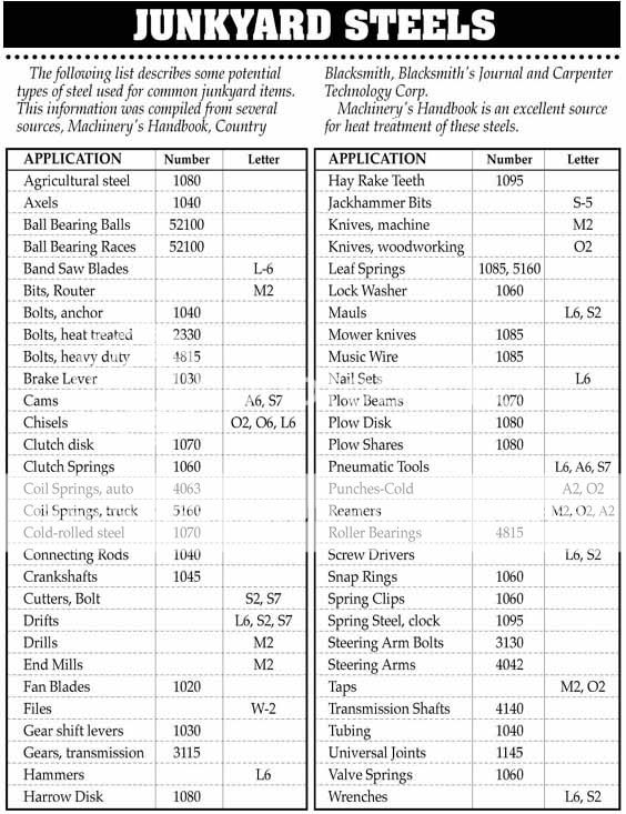

Hi,
Here is a very generalized, yet handy chart to use whilst wandering the scrapyard.
But like me, it's a bit old. Things like new files are often some propritatry mix. S5 isn't a very common steel anymore. So use with judgement
