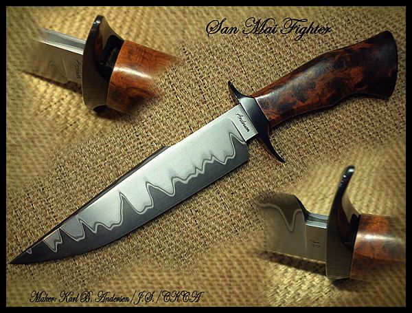

As a side-note to this San Mai discussion, the entirety of the undulations you see at the bottom edge of the 420 jacket is created using drawing dies.
I make no other actions to influence this edge other than drawing dies.
I know some guys cut into the billet after the initial weld to sort of create activity like in pattern welded steal, but what you see here is nothing other than drawing dies.
I say this, because it's a perfect visual representation of what is going on inside your steel when using drawing dies! :)
That is some beautiful stuff Karl.
