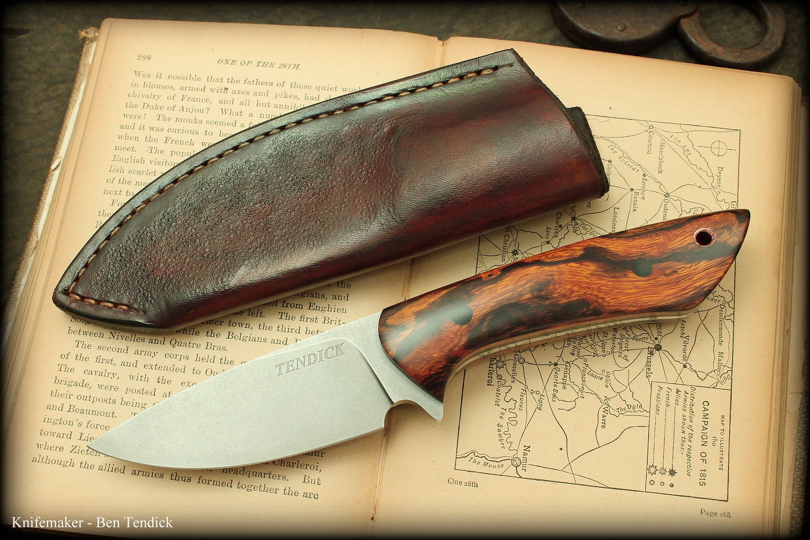

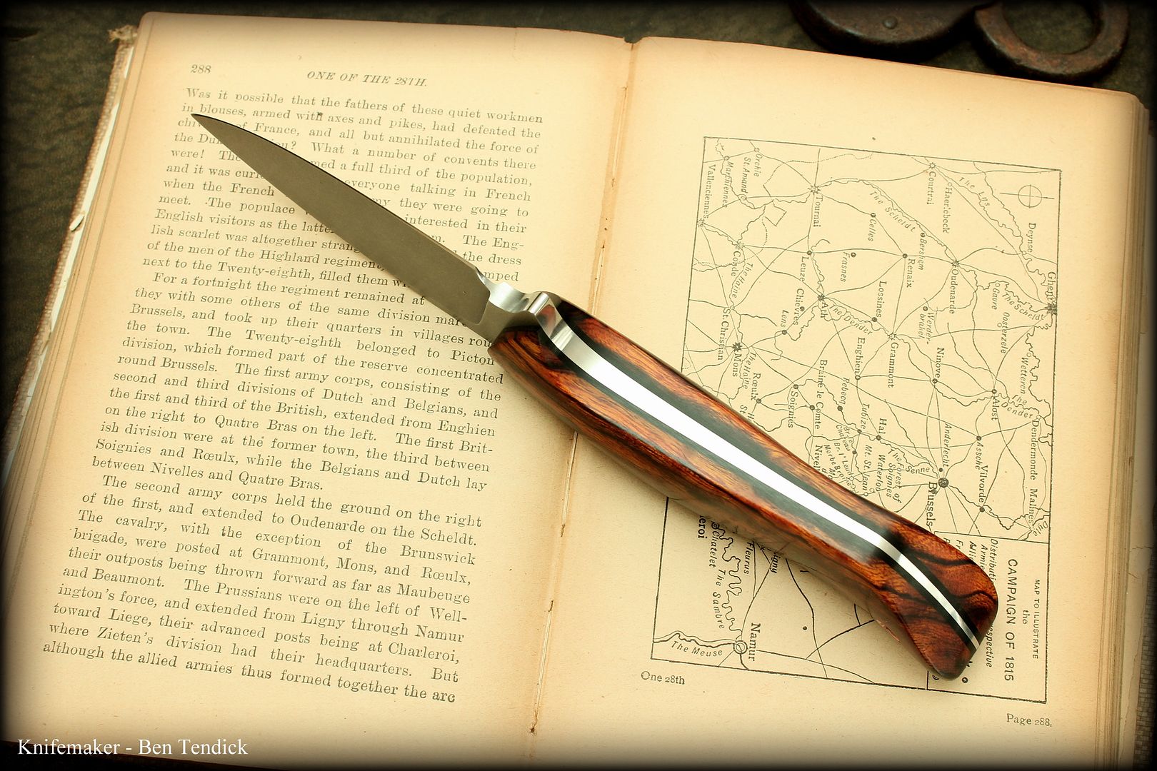

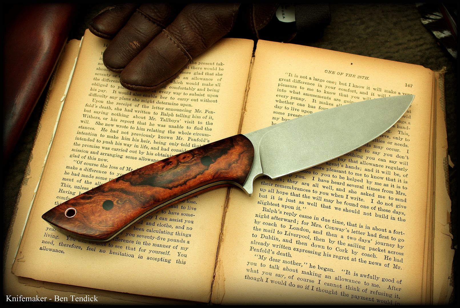

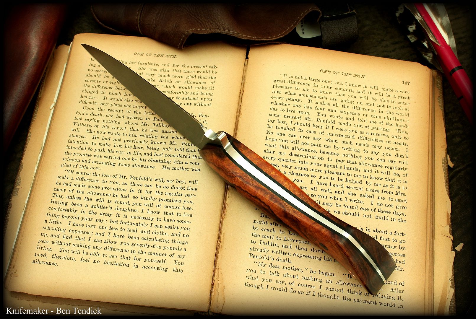

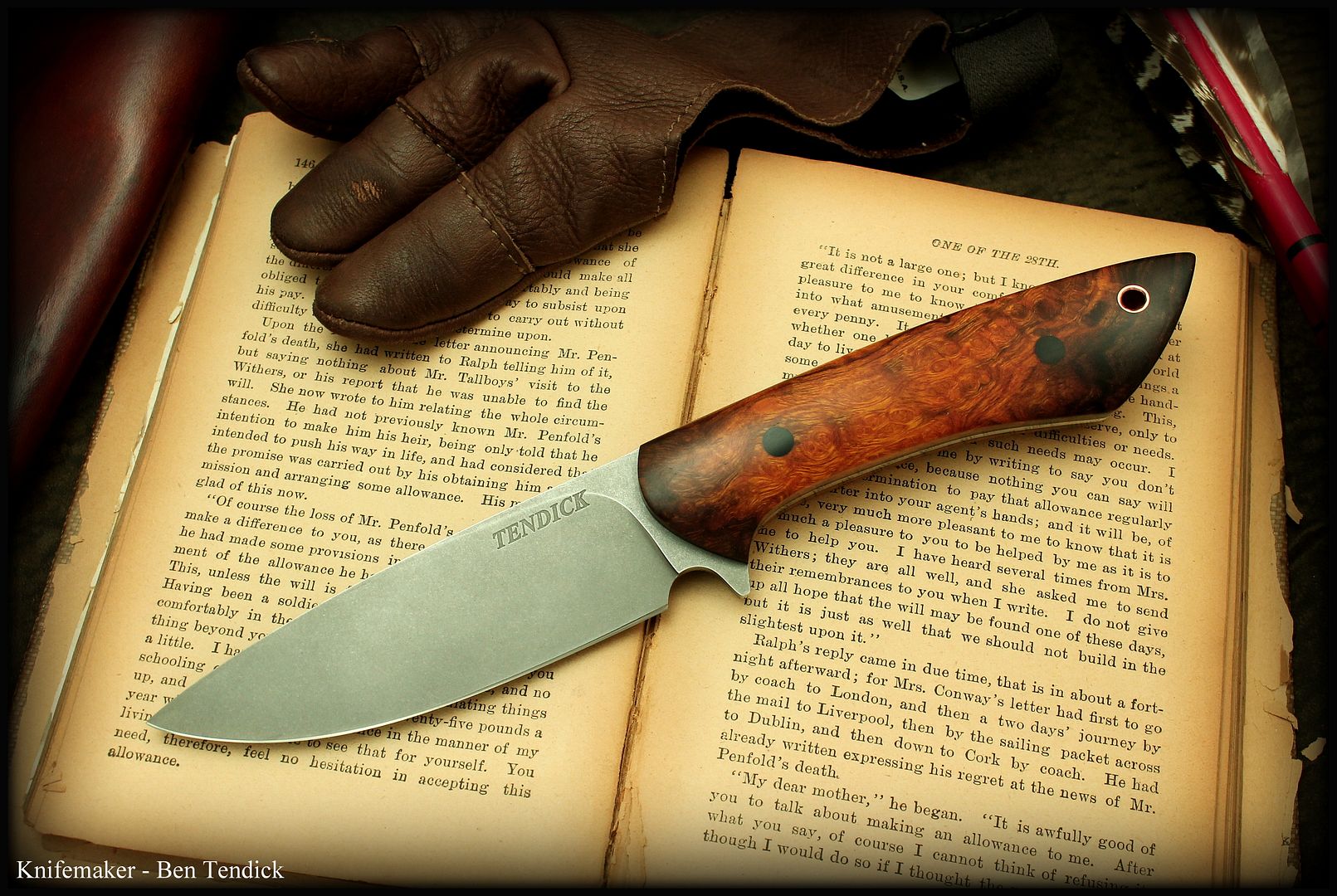

Here are two different knives I just finished up, both with really nice Ironwood handles. The first one is my new model "Compact" scout with a 3.5"
blade and the second is my full size scout with a 4 3/8" blade.
Both have CPM 154 blades that have a nice stonewashed finish with polished spines. The pins a carbon fiber and the lanyard tubes are copper.
Any and all comments welcome!

you're rockin that handle contouring like nobody's business!
Interesting contrast of the contouring with the geometry and bold lines of the profile. The contrasty wood, (which is beautiful) speaks to this.
Not a fan of the lined lanyard hole, I think it would look more cohesive without.
A hand rubbed or polished blade would add an extra touch of class, imo.
Looks like a super user, Ben, I do like tubed/lined thongholes.
Nicely tapered tang.
..and DI RULES as far as I'm concerned, beautiful and bombproof.

Thanks Lorien. I am the opposite I guess, an empty lanyard hole looks unfinished to me. The one thing I like about the copper, is that if you didn't like the bright finish you could always patina it or just let it darken naturally.
Hand rubbed does look sweet! I think the contrast between the polished spine and satin stonewashed blade look really nice and are very user friendly.

Ben, those are very nice, very clean. Can I ask how you did the blade finish?
They have a stonewashed finish. You have to start with at least a 220-320 finish, sandblast, and them tumble. If I want a darker finish I will give it a soak in feric after blasting and then tumble.

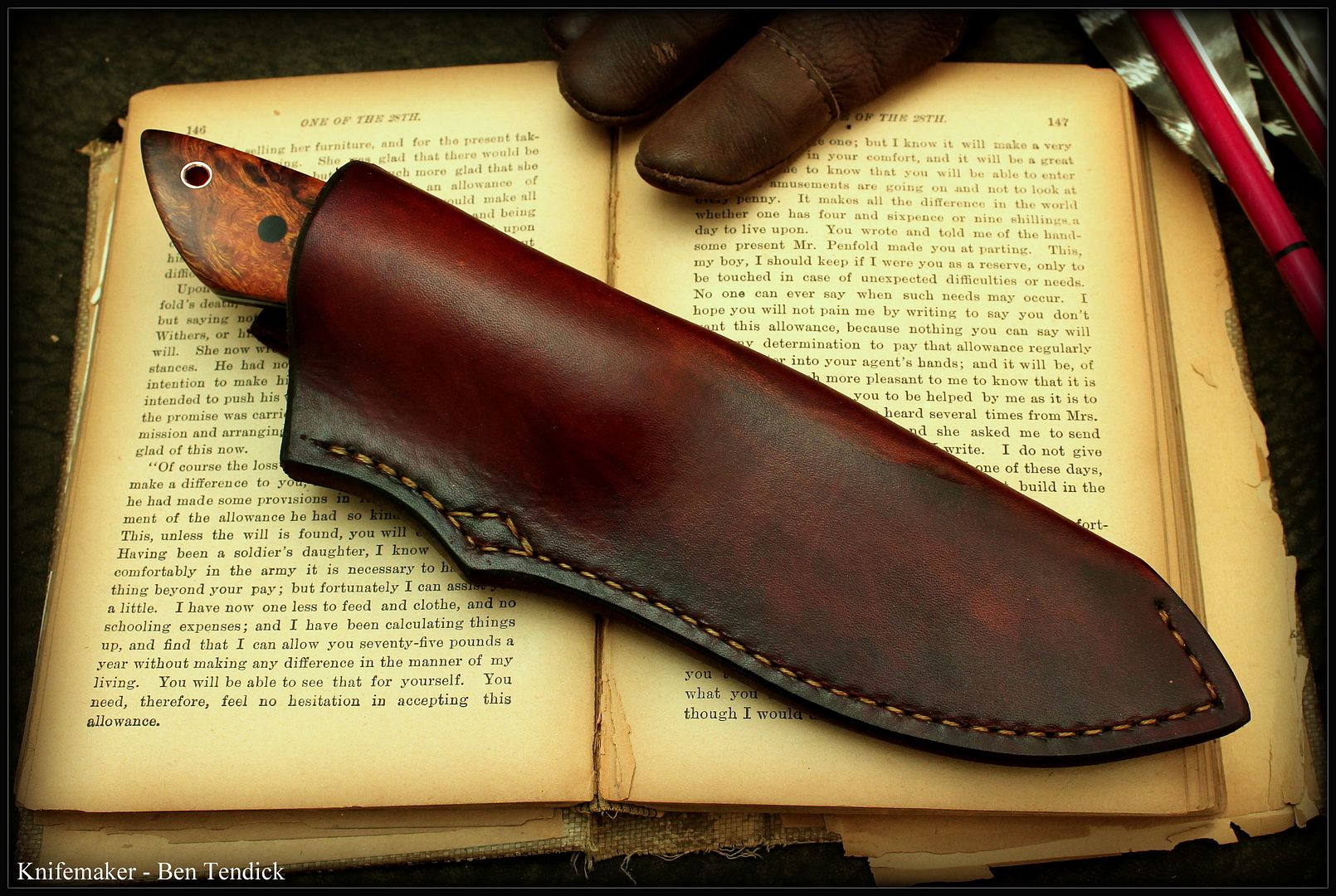

Truly beautiful. Love the stitch detailing and leather finish for the sheath. Do you sell these online?
Ahhh seen the link! will be having a good look soon. Discounts available for bladeforums members?
