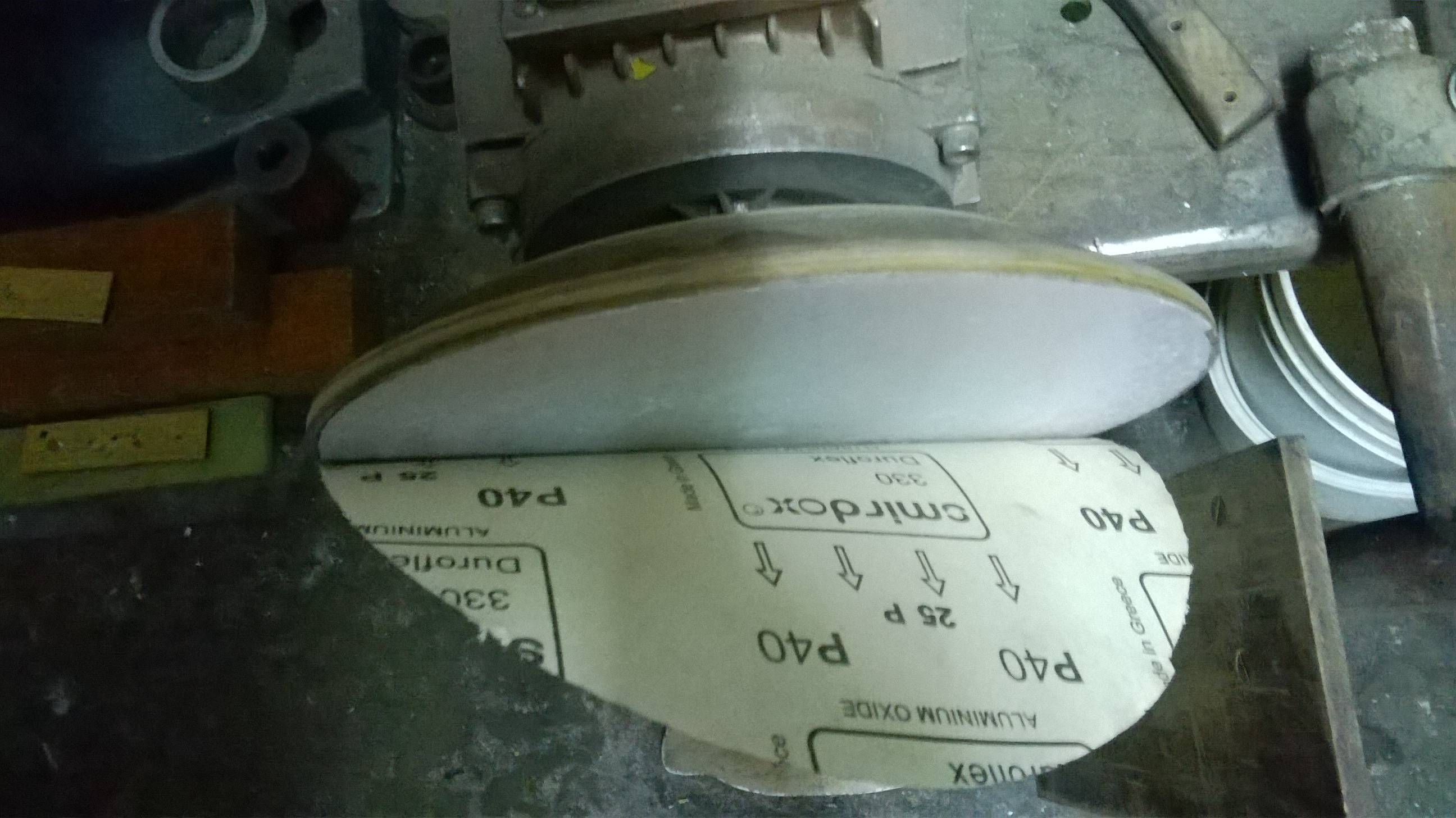

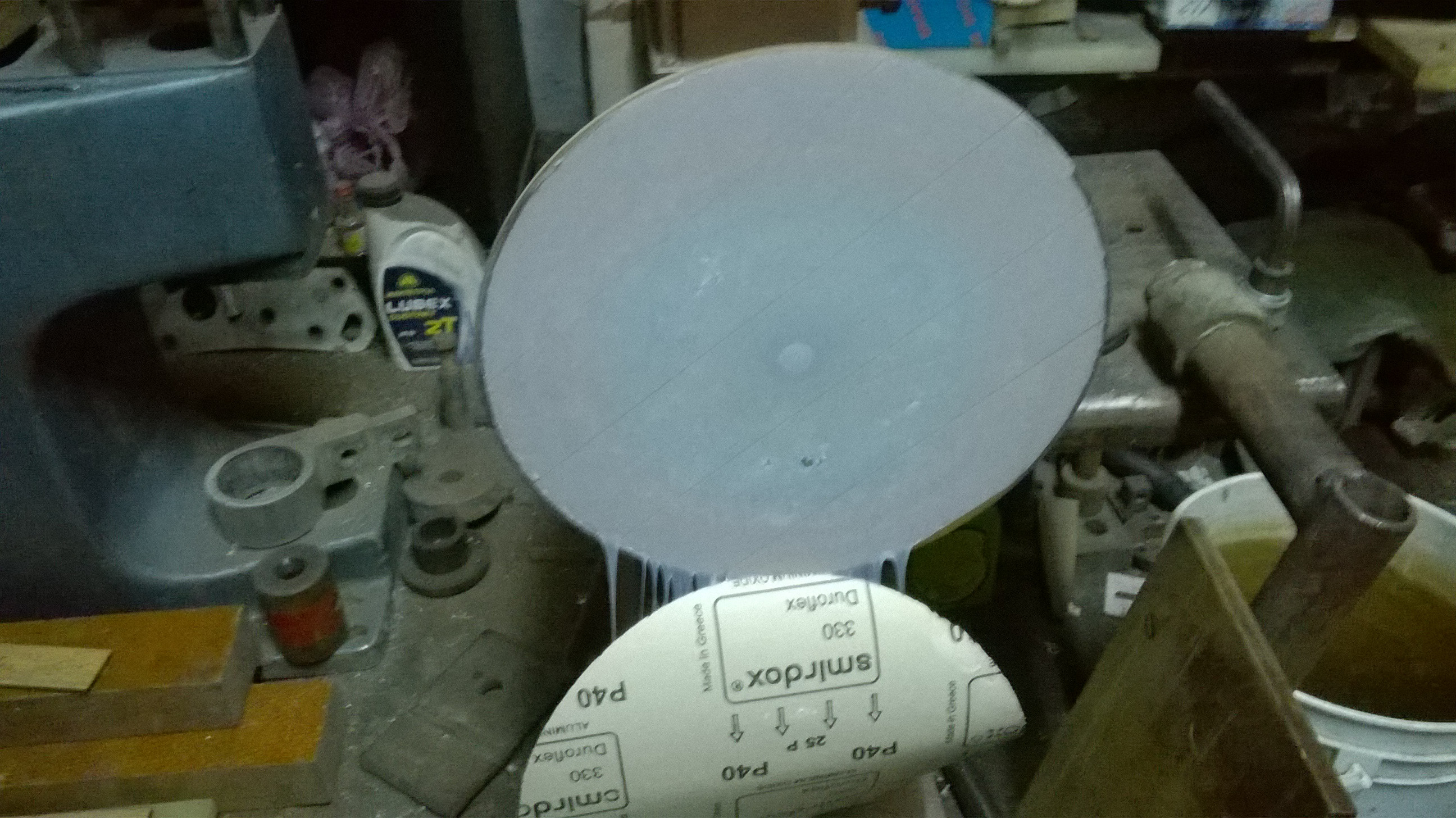

On my disks I use only 40-80 grit sandpaper . I use thin Double Sided Sticky Tape . I leave a small part on the edge of the disc /in one place , not around all disk / with no double sticky tape and I mark that spot with marker on disk. ... That way it's easier to change paper. Sometimes I successfully change 5-6 disk paper before contaminating and damaging tape .....But it is cheap and is easy to take of with some nitro solvent .............

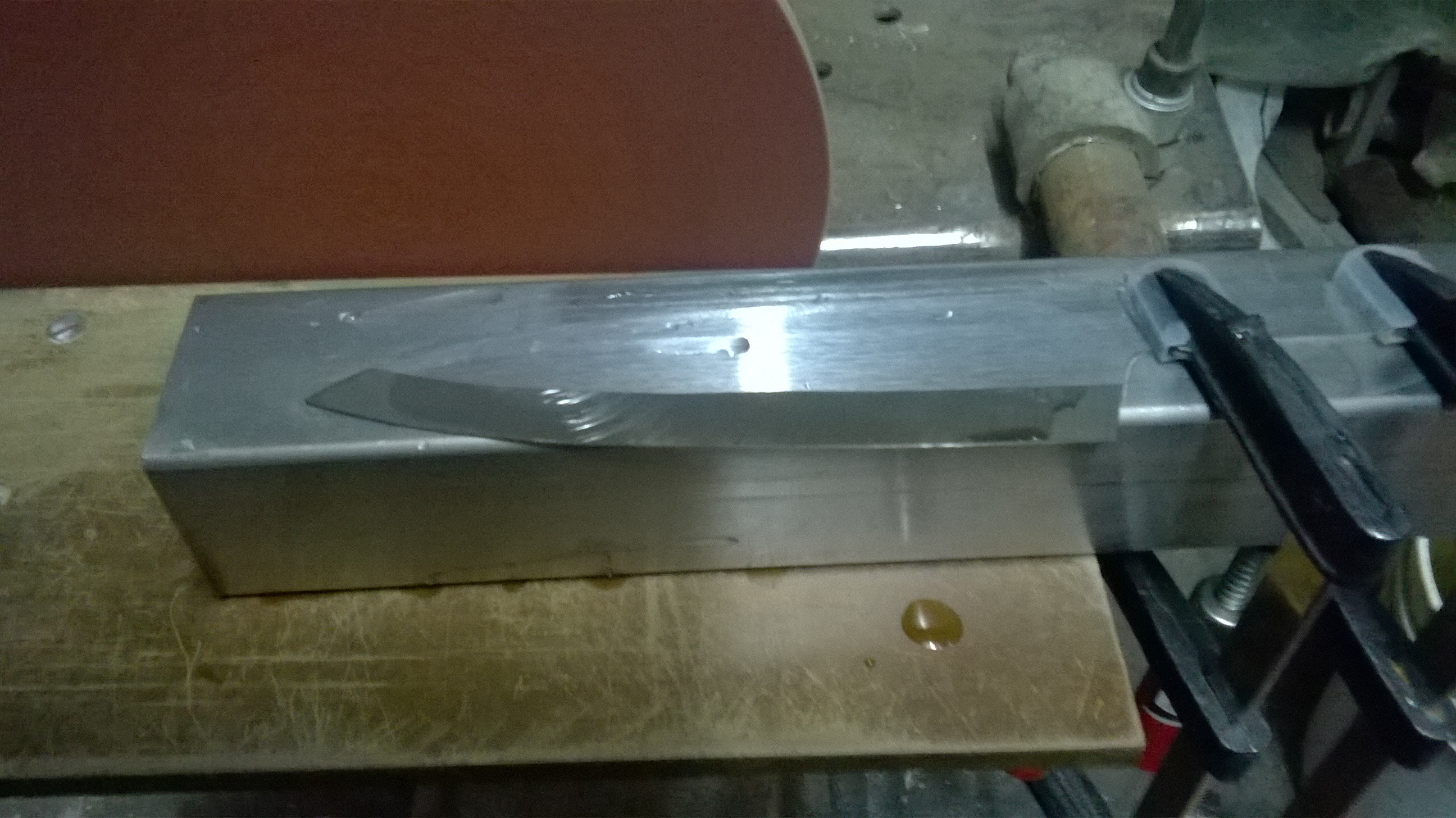

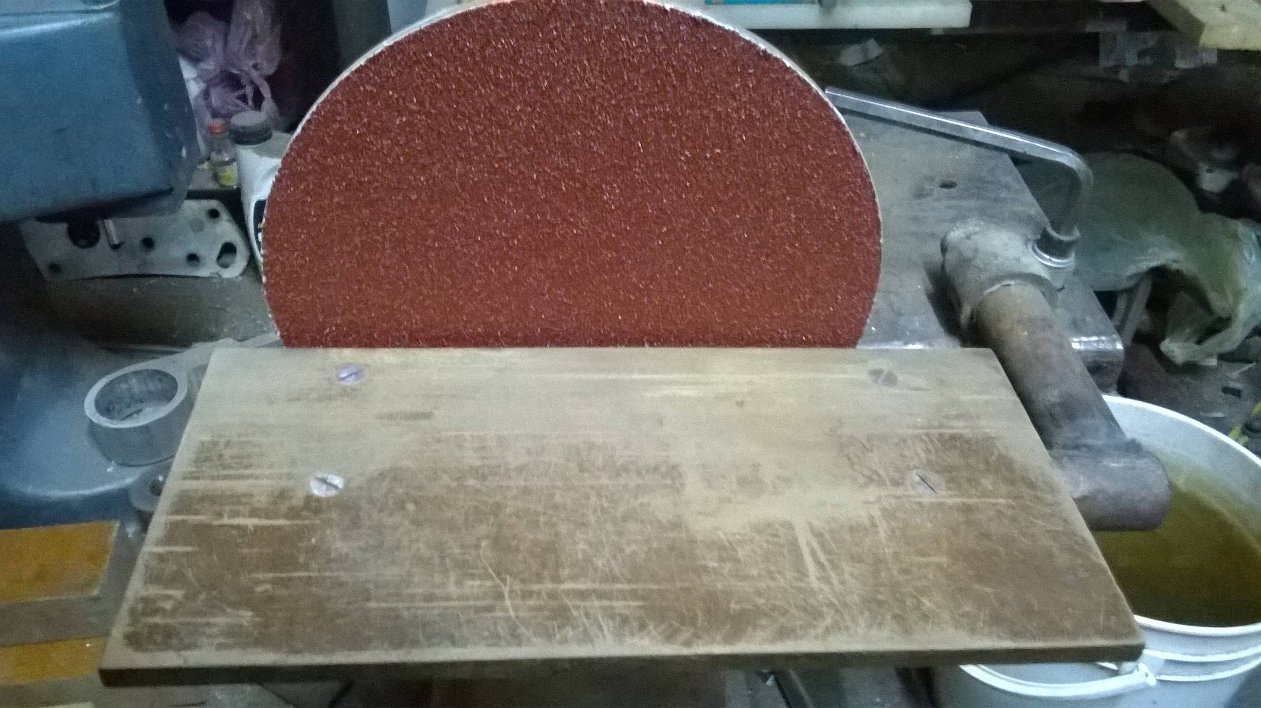

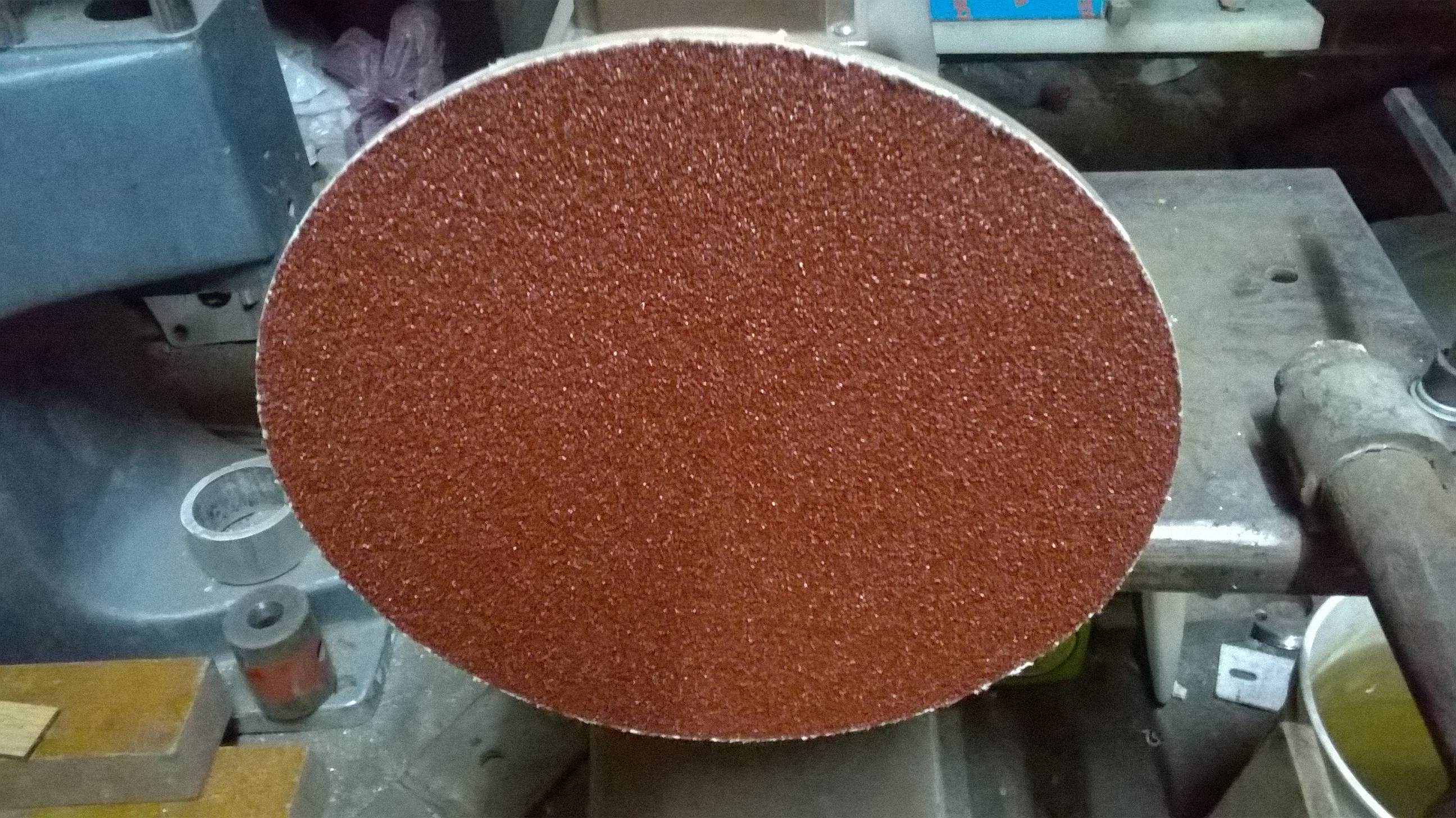

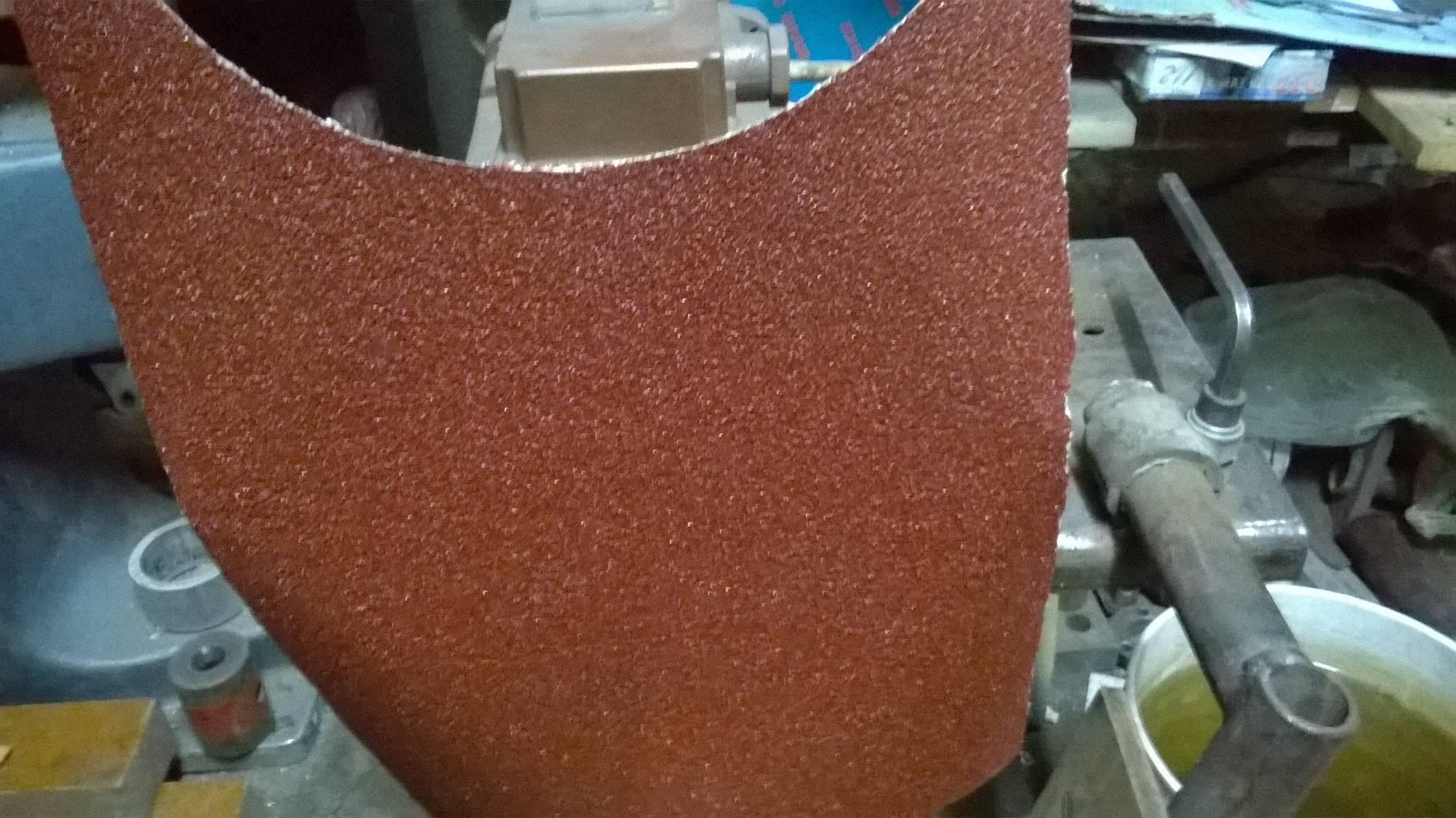

Here are a few pictures , they better speak English than me . . . :) It takes minute to change sandpaper ......... Look , I have three disk sander .Two on 2800 rpm and one 1400 rpm/min for working on wood . When on first disk sander /2800 rpm/min/ sandpaper start to heat blade I switch on second one with NEW 40 grit sandpaper .And first one I continue to use ONLY for shaping knive blank or other job .That way I use sandpaper to maksium ;) With one 40 grit AO sandpaper I manage to grind 3 blade in 1.5mm hardened steel ... Enough for half a dollar paper :thumbsup:
And three minutes later ............

I like how you did that thin knife Natlek.
You inspired me to try a kitchen knife on there. I've cleaned up bevels on mine before, but never went to the disc at the beginning.
