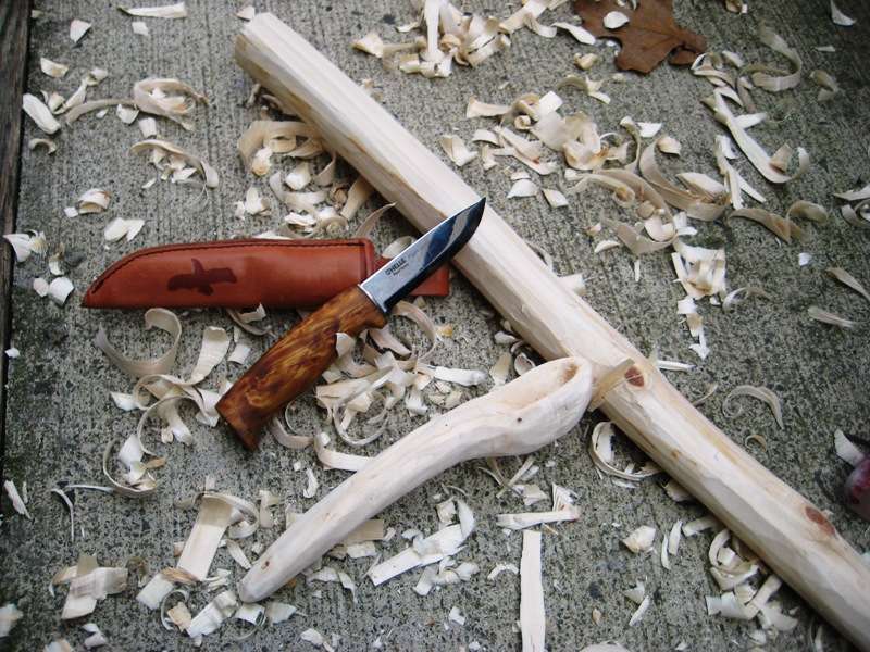

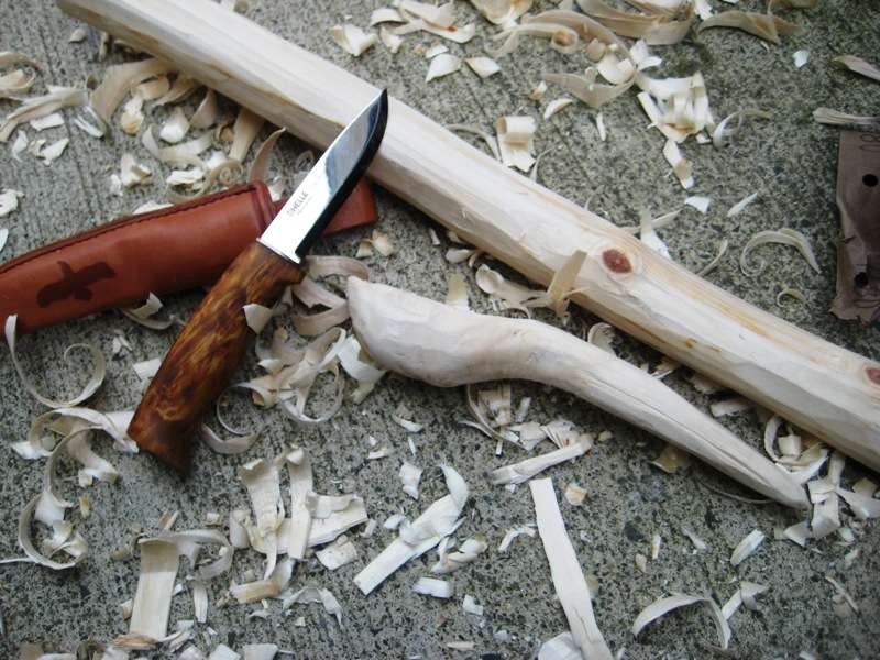

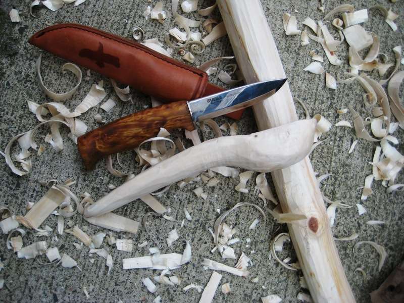

Just thought I'ld share this. I made it pretty quick with my Helle today. Nothing more relaxing than having a beer and doing a lil whittling is there...
I really need to get one of thosed curved carving knives, but I guess it could of came out worse.

Is that to eat with, it just looks too thick and bulky. I'm not saying that your spoon is bad, but I see alot of people make big spoons like that. Do you ever use that? It seems it'd be hard to eat noodles out of a soup can with that.
Everyone's a critic;):p
Just kidding. It is big and bulky, you are correct. But with over 4000 post in one year, you should know I have a big mouth:foot:

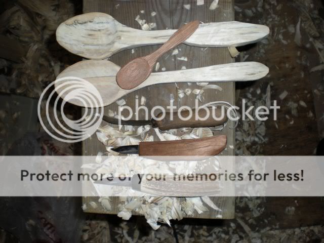

Beech, sycamore and birch are all good "food" woods, avoid hardwood burls which can be VERY difficult to carve, also avoid poisonous woods like yew. Lots of woods make nice spoons, my favourite is sycamore, it was in fact imported into the uk for the specific purpose of making eating utensils.
i'll go and ifns a couple of pics.

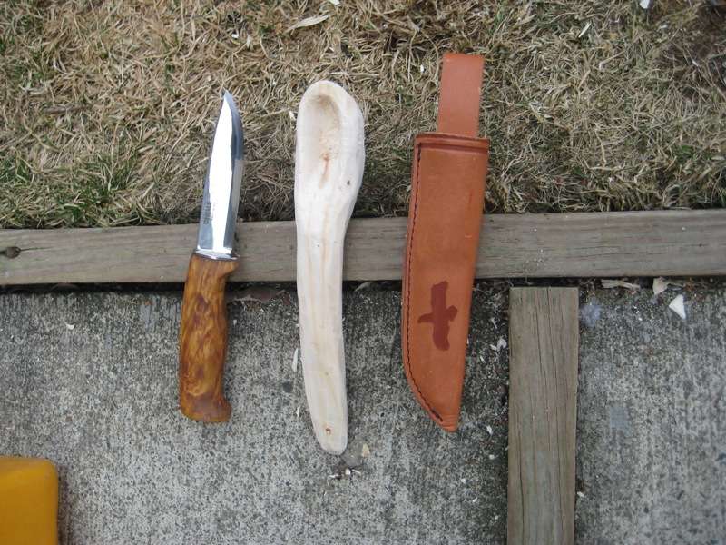

Tony, you see how much further you can carve a spoon with the 'curved/spoon type knives' Nathan used. The one you made with my, cough, Helle would be fine in a pot for stirring. If you size down what you made it would work fine for eating. Just make your spoon 'bowl' wider when you start and you'll end up being able to make it flatter and as deep as you want.

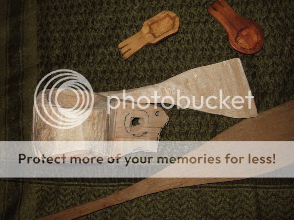

Tony I like both the Helle and the spoon! I used to make big, oak kitchen spoons, but I've given them all away. Below is a Oak spatula I made along time ago, as well as a a small one that I was messing with today... My kuksa failed.. It did exactly what I said it would do, cracked and split while drying.. So I busted out the monster nessie and started over!
