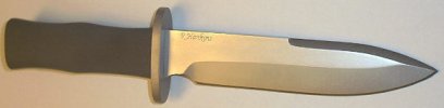

Who you callin "Plain Jane" Ready to kick arrss and take names.
Fighter I just finished and thought you might enjoy seeing.
Nothing fancy but will definitely get the job done.
Made from 1/4" edge quenched O1 tool steel
Bead Blasted with a Industrial Hardchrome finish
Blade is 6 7/8" tip to guard
11 1/2" OAL
416SS guard
Solid Micarta handle
Flat ground with a Convex false edge
Stay Tuned
