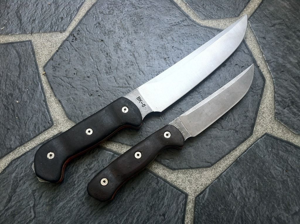

I made a set of scales for a BK2 once. I think I used maple. Turned out well. I mimicked the OEM scales and used a tiny chisel to cut hex-holes for the hex bolts. That took some patience. I gave that knife away, so I don't have a pic.
For my BK5 I replaced the scales with some micarta. The scales are a bit thin and I wish I had started out with slightly thicker scales. Micarta is a bit of a beast to work with, too. But the new handle is good and the knife is a user.

I used brass tubes from the "hobby" drawer in the hardware section at Lowes. Tapped it with I think 6/32 tap and used 6/32 x 3/8" screws. The tubes are an exact fit on the bk5 once the coating is gone from the holes. The 15 had to be drilled and that was quite a chore even with a drill press. After the fact it was suggested that a carbon tipped bit would have been better.
These are leather scales. I can dig up where I posted a WIP thread if you'd like but I'm not sure it would be much more help. Originally I used 1" aluminum Chicago screws and cut the threaded tube part off to use inside but they seemed weak. When I did the 15 I changed both sets to brass. I like having screws on each side...takes care of any asymmetrical OCD issues lol
