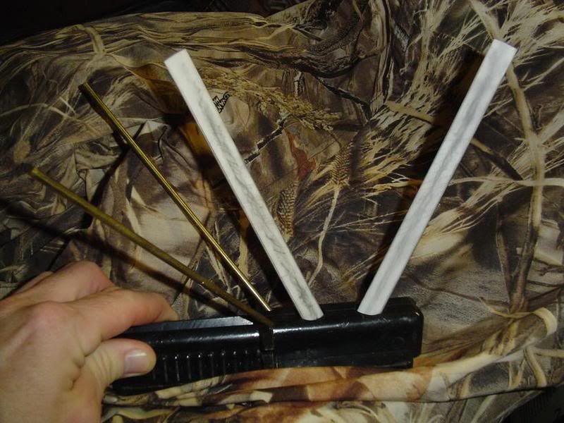

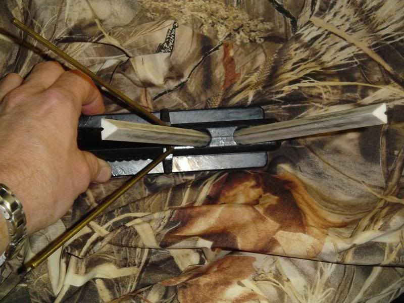

its a little bit harder to sharpen...
I've found re-curves to be a lot harder to sharpen personally. The only re-curve that I have used extensively is the Emerson Commander. No matter how hard I try, the "re-curve" part of the blade doesn't seem to hit the stone.
The belly is polished to a mirror, but just below that is virtually untouched. If anyone has any suggestions I'd try them.
How do you sharpen the entire edge of a re-curve bladed edge?
I have had good luck with the Edgepro stuff and sharpening them. The stones are narrow enough to do the job.
I use a Spyderco Sharpmaker to sharpen my serrated and few recurves that I have...
