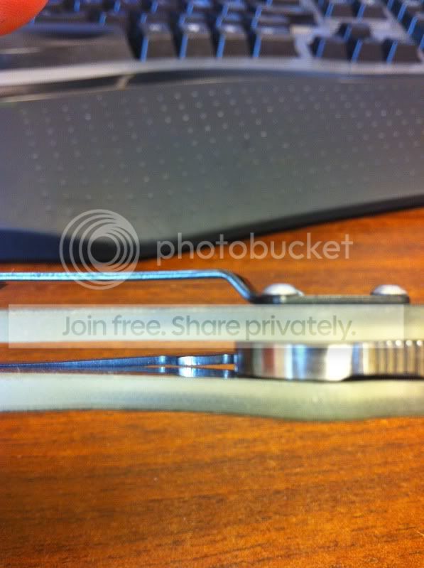

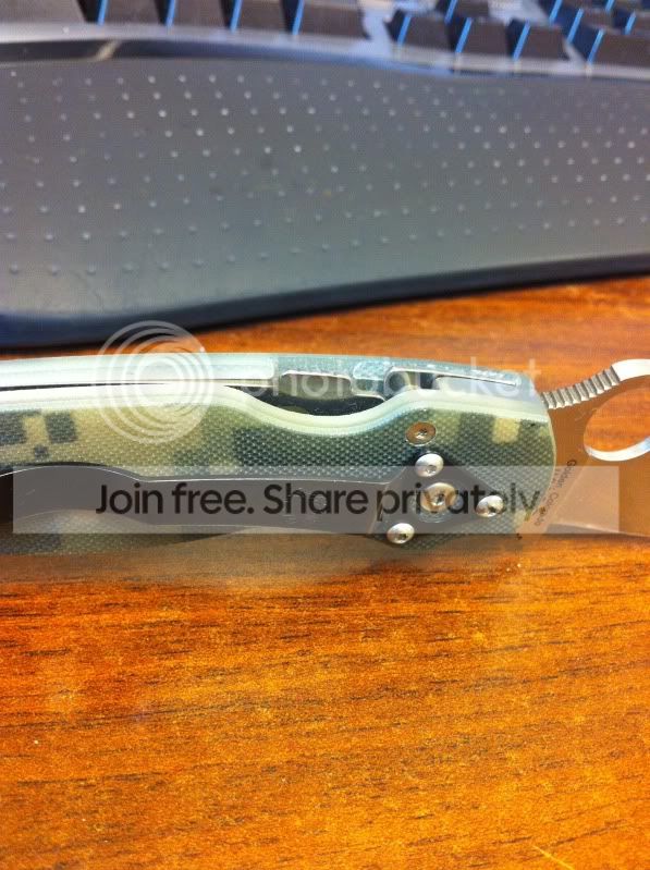

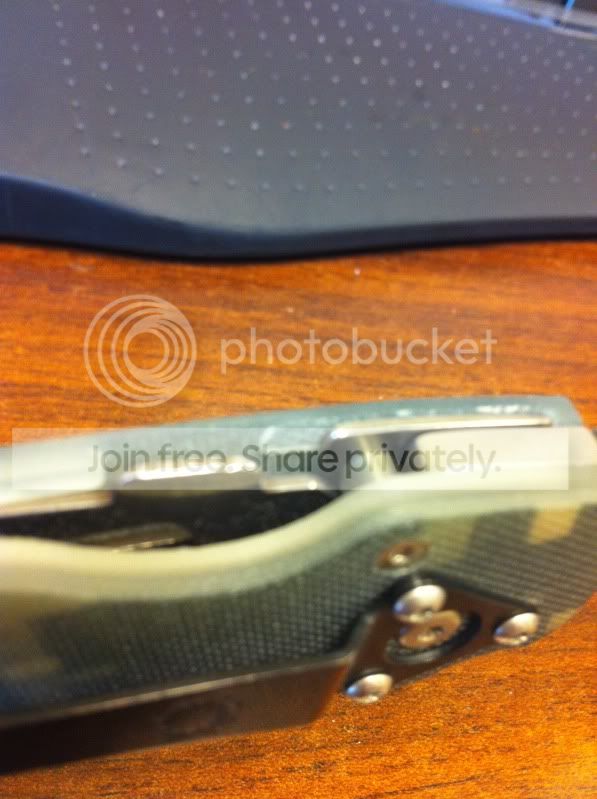

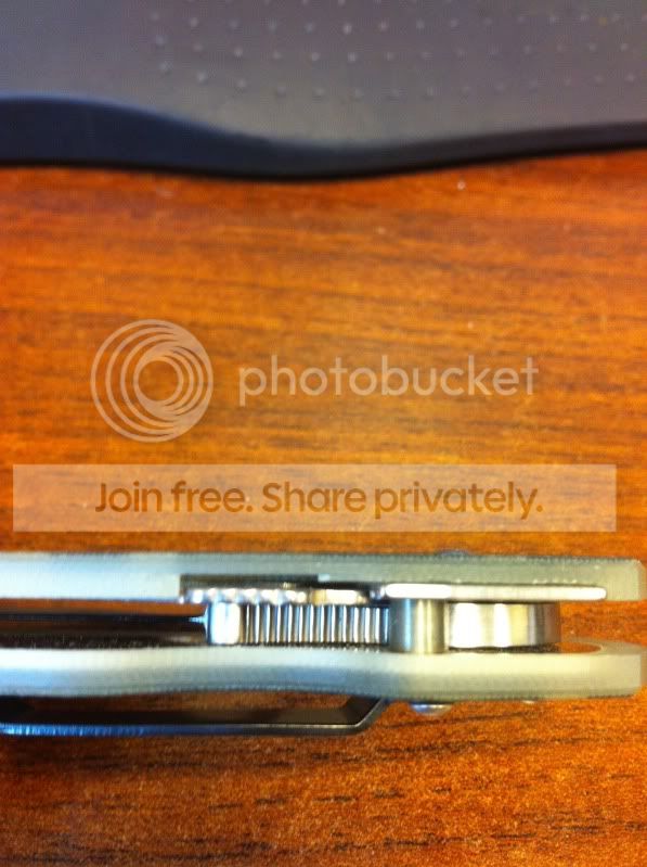

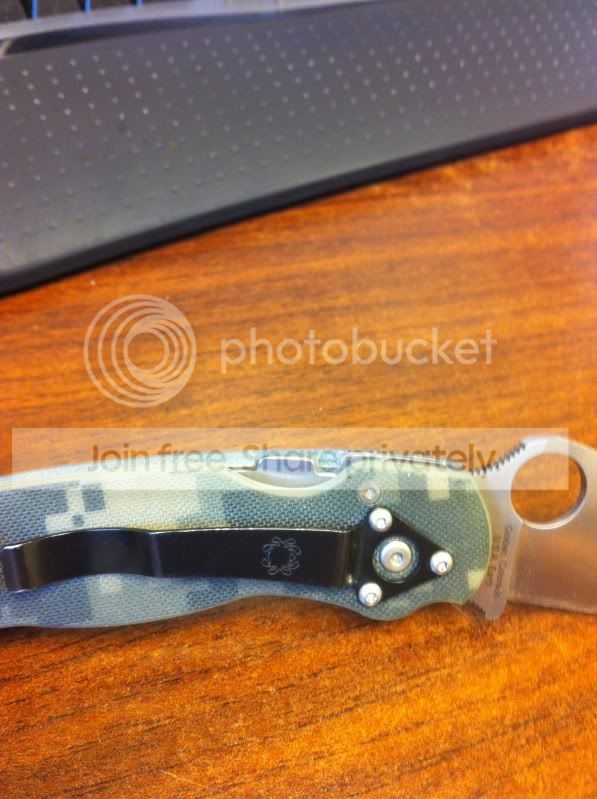

I'm sorry but can anyone show me how this locking mechanism works and what improves the strength of it?
I thought it's just like the liner lock :P
i happen to have some pics in my photobucket:
its not a reversed liner lock. the liner on the compression lock is compressing the stop pin between the blade tang (sorta like the triad lock) it may look like a liner lock, but it is much stronger.
oh now I get it.
thanks man
