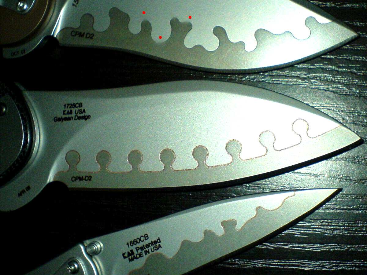

I have no problem with san mai to make a knife a little better. I only see real value in the bush/survival or cooking categories though. Although, I'm also a big fan of the Kershaw Leek composite for EDC...
