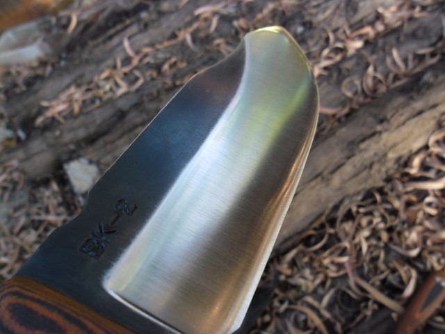

I use 80 grit to start with and then 120, 180, 400, 2000 and strop. 220 you'll be there for along time...

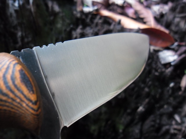

BK-2 Convex Edge by CamH_16, on Flickr
001 by CamH_16, on Flickr
per the OP...
it's a matter of cost and production...
it would cost 2-3x as much, they couldn't make as many as fast, and they wouldn't sell :)
let's face it, a lot of people buy Beckers because of the value, despite the fact they are clear the best :D :D :D :D :D
we've already seen what happens when a Becker is over $100, slow sales, except for the BK77 limited. you guys are clearly about shopping for value.
oh, and the factory edge is pretty darn good, so, well, there you go.
