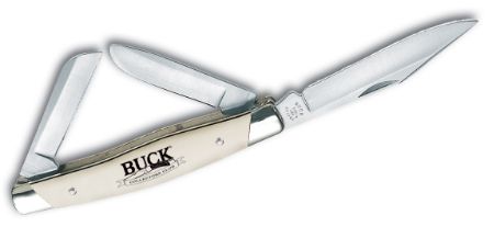

On the above 301 you gave it upgrade handles. Did it merely require clipping the heads off the pins and the old ones fell off. Woops, that looks to be an old one and it may have required more work.
Is this true for the newer 301's? Thanks, DM
The Ivory scale above it the one that your spouse engraved 300Bucks on reverse. The old Camillus scales are riveted. The new Buck scales have the built in plastic scale rivet. Somewhere I showed a bunch of photos of this in the past. The new ones you sort of carefully cut/pry off.

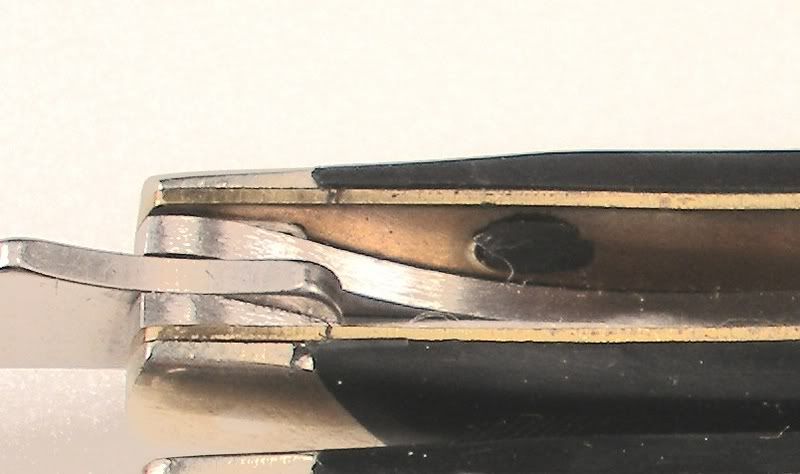

See the flat melted plastic scale material. They are stepped depressions, that once pin like projections from back of scale are melted into place act like plastic rivets. Black scales have external spring rivets also, new Dymondwood models have hidden spring rivets.
Here in this close-up you can see some smearing of the melted plastic on the SS liner.
Ones with Dymondwood or Rosewood/Brass bolster shown, are just riveted on. Spring rivets under scale.
