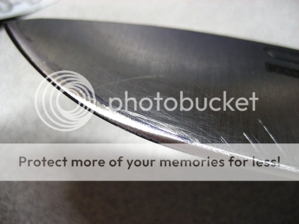

Okay, so just got my fatty warden from the BCS... I swear, I have spent 4+ hours on this thing trying to get it sharp on my sharpmaker... it just doesn't want to...
one side sharpens up fine, while the other side the grind angle was so big, I have had to try and use sandpaper (150 grit) on the flat surface of the triangle stone, on the 30 (15 on each side) degree angle to try and back bevel it down.... I am still just a little bit off getting to the edge on the 40 (20 each side) degree setup. I used the black marker trick, and I can see that right near the edge is still black.
I also tried hand sanding the profile down on the "bad" side to no avail... but did manage to get some not so nice scratches in the blade... how do I polish those out and make it look nice again?
What is up? I put in an order for the Edge Pro Apex today anyway... any and all advice is appreciated.
bad side, with scratches shown... can clearly see black marker near edge

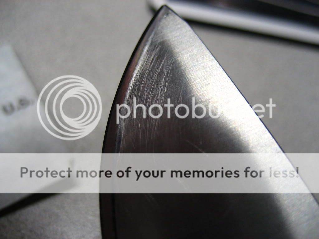

more scratches...
more...

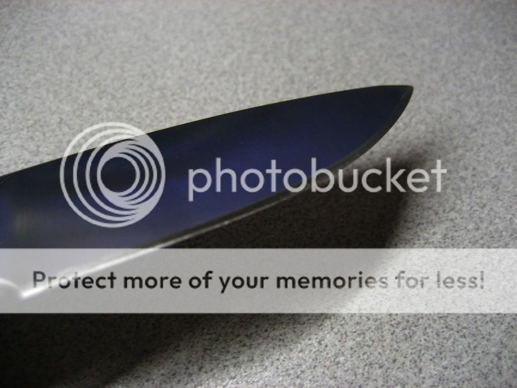

the good side....

Your photos show that you are knocking off the curvature of the convex edge and starting a flat "V"... that's heavy work with a sharpmaker.
Your edge pro will be more effective at re-profiling... but...it's not too late to stop and learn how to sharpen a convex edge.
